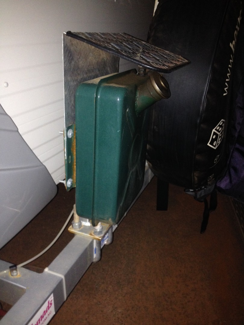

Well I had a bracket made up which bolted to the rear bumper of a Coromal. Also put a cover over the top to keep the rain off.
Is this ok with the law makers on the rear bar. looks good.
Jim

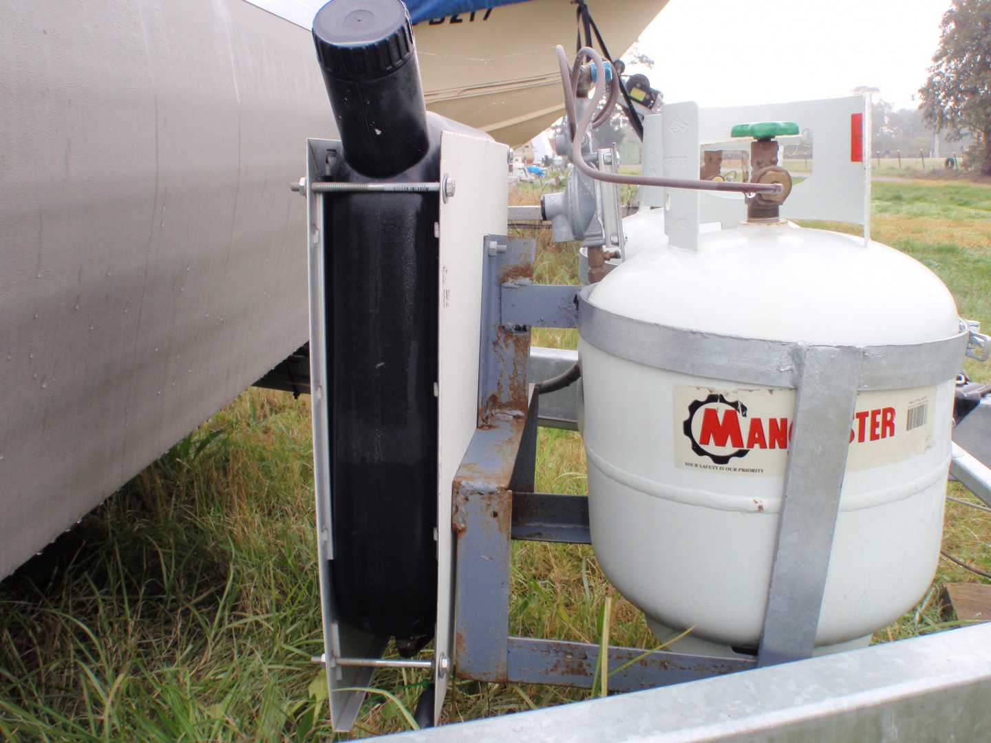

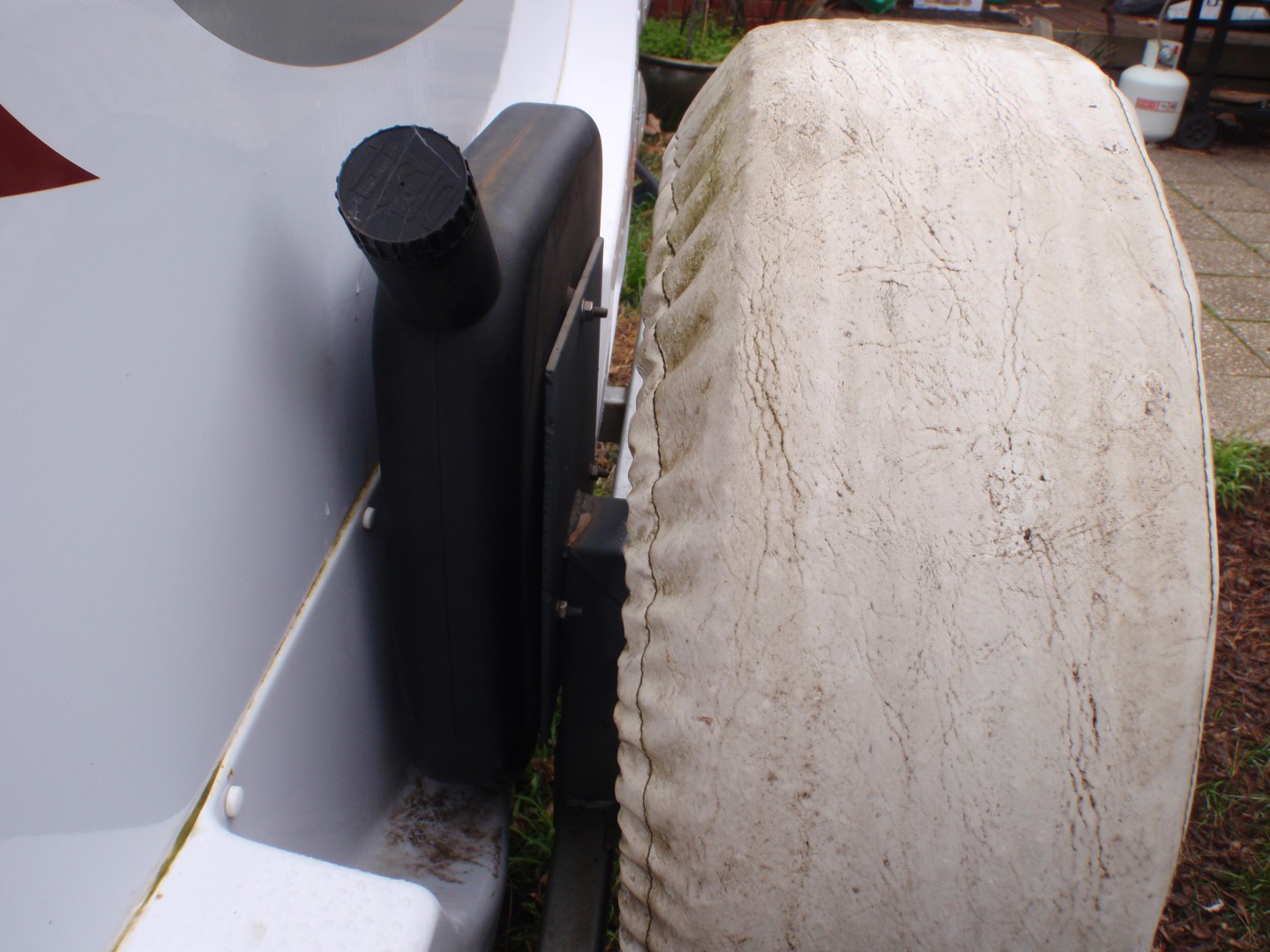

There is no way I would fit the tank in the boot because of spillage when filling. I have fitted two tanks, one to the rear behind the spare tyre and one off the gas bottles. The one off the gas bottles I moved to the side of a toolbox I fitted on the A frame, this has been the best fitting so far but I do not have any photos of it.
Hi Glen,
looks good.
Jim
Snail
Hi Snail,
Thanks for the photo's.
Jim
