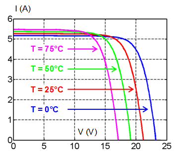

11:15 PM May 25, 2016
The following diagram shows the effect on the output of a solar panel as it heats up.
