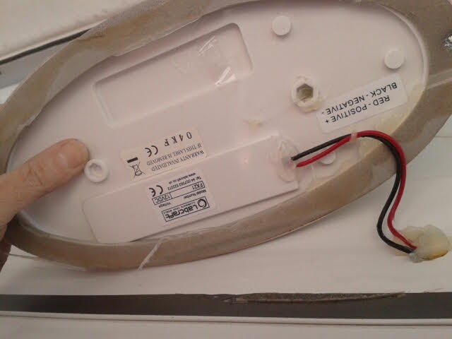

hokianga said
02:49 PM Apr 17, 2016
Hope this works, been ages since I posted a photo.
Does the' Labcraft' piece where the wires enter lever up??, can't tell if it is a single piece molding or not. Might help with a photo of front side as well.
Could try google with the Labcraft model number as another option. Sorry can't help more at the moment
http://www.grassroutesleisure.co.uk/products/240/labcraft-opal-fx21-awning-light seems to be the same light and reading the blurb seems the lens is just clipped in at the front?
-- Edited by Cadpete on Sunday 17th of April 2016 07:26:22 PM

I got a printout about the light, it seems to say that there is a special clip and o ring arrangement to get the front bit off. I am too scared to force it as it's not my light.

madaboutled said
08:00 PM Apr 18, 2016
I've converted a few of these types of lights over to LED for a few people over the past couple of years. The cover comes off from the front, you need to use a small blade screwdriver to gently pry it off. If the fitting is old or has yellowed then it may be very brittle, so lots of care needs to be taken so you don't crack the cover or damage the lugs. If you shine a strong light (torch) around the edges you can some times see the notches where its held into the main body. Knowing where the notches are helps as you need to gently pry the cover lugs out from either side of the notches.
Hope this helps, Regards Steve.
