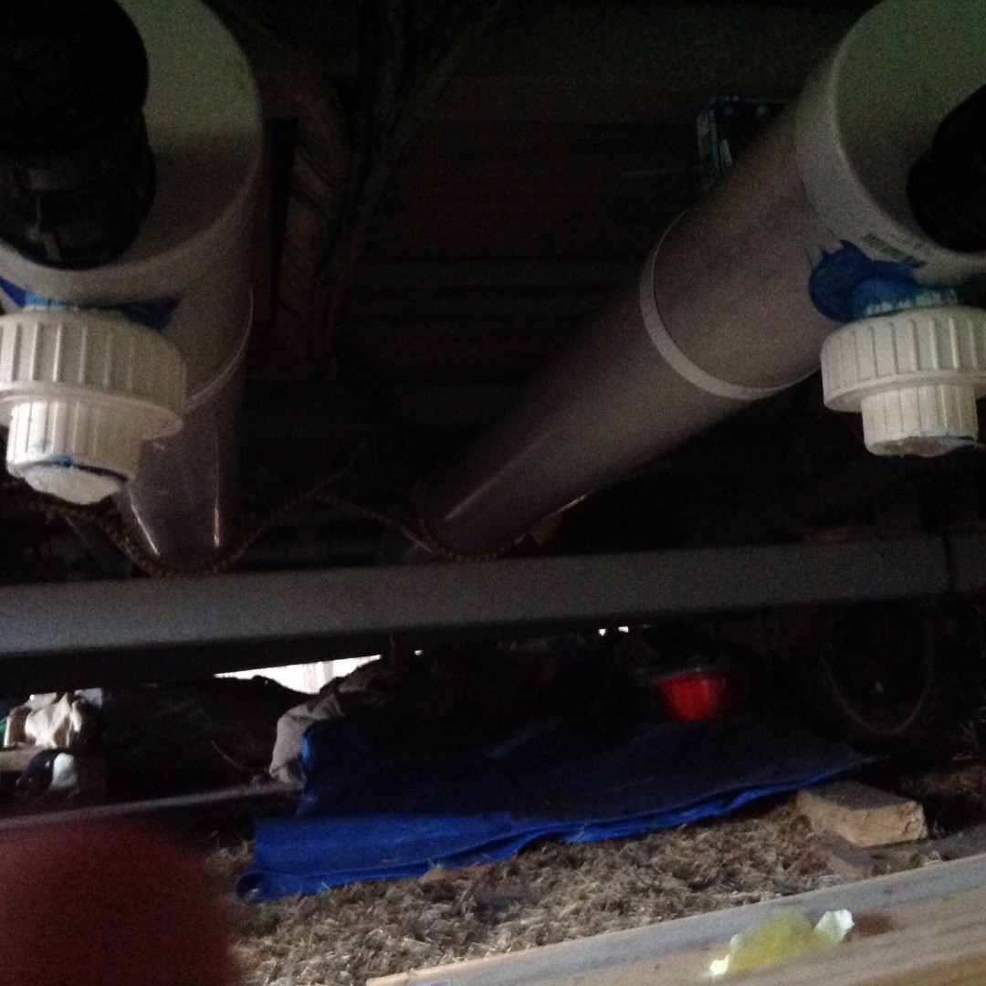

Well finally got my grey water tanks installed with the necessary changes to the plumbing under as well. Using 2x 100 mm pipes about 2meters long installed above the axles joined together at one end with tee on each one and another tee in the middle to act as a breather. One tank is for the kitchen sink while the other is for the shower and hand basin in the toilet. The idea is that if one tank fills before the other it will just flow into the other.
the output come out from the two tanks using separate drain pipes with stop taps on each. Just finished testing and it works well.
Don't what sort of comments this will draw but for me it works ok and will allow us to store our grey water when we need to.
if you want to use any of that info for yourself, go for it.

05:50 PM Apr 15, 2016
Photo as promised

Dunmowin said
07:55 PM Apr 15, 2016
What is the storage capacity of esch tank?
briche said
08:21 PM Apr 15, 2016
Hi Dunmowin, around 20 liters per tank. Not a lot but enough to do the job. Too much capacity equals too much weight.

09:02 PM Apr 15, 2016
I calculate 15.708 litres approx plus a bit in the pipes..
Mobi Condo said
09:37 PM Apr 15, 2016
Very nice work - timely for me to read as well. Coupla questions.
a) are there any baffles to prevent slosh motion etc
b) any clues as to how to valve the shower run to prevent "slosh back" into the shower?
Cheers - Ian
briche said
10:55 PM Apr 15, 2016
Hi Moib Condo, did consider that but no baffles installed 'mainly as I don't intend to travel too far with water in the tanks. we would drop the load ASAP leaving the site where the tanks have been in use. I am sure the local trees and shrubs, etc will say thanks.
the piping from the shower is located higher than the tank so I am thinking that we should not be a problem but as mentioned no not intend to leave it there for any lenght of time.
hope that makes sense.

Treecrest14 said
12:13 AM Apr 16, 2016
Another idea..
As we free camp, I installed another 95litre tank and put in a T piece with a stop **** on the tank to divert the grey water into the tank by opening it and also closing the exit outlet stop ****. Decided to install S traps under the sink and ensuite basin to ensure we didn't get bad smells back into the van from the holding tank. Shower outlet is too low for a S trap, so intend to put a plug in the drain when not showering. Couldn't find a large enough one way device to stop water in the shower drain pipe coming back when travelling. We would close the grey water stop **** when moving the van with grey water on board, to stop water sloshing back into the shower.
95 litre will hold a few days free camping - and wont increase our weights as we are basically transferring the water from one tank to another, mind you we do have 190 capacity of potable plus the grey water tank.
Glen

erad said
09:46 AM Apr 16, 2016
My main concern with your setup is the lack of clearance betwen the grey water tanks and the axle. You may have contact if you hit a large bump.
-- Edited by erad on Saturday 16th of April 2016 09:47:24 AM
briche said
10:49 AM Apr 16, 2016
Did consider that erad, and at the end of the day came to the conclusion that it would be enough given that we don't venture onto roads that are in bad state of repair. Also the actual tanks are suspended in a harness that allows movement and all the connections are via rubber hose so I am trusting that all goes well.
I guess over time we will see how it pans out so I will keep an eye on to see how it copes.
