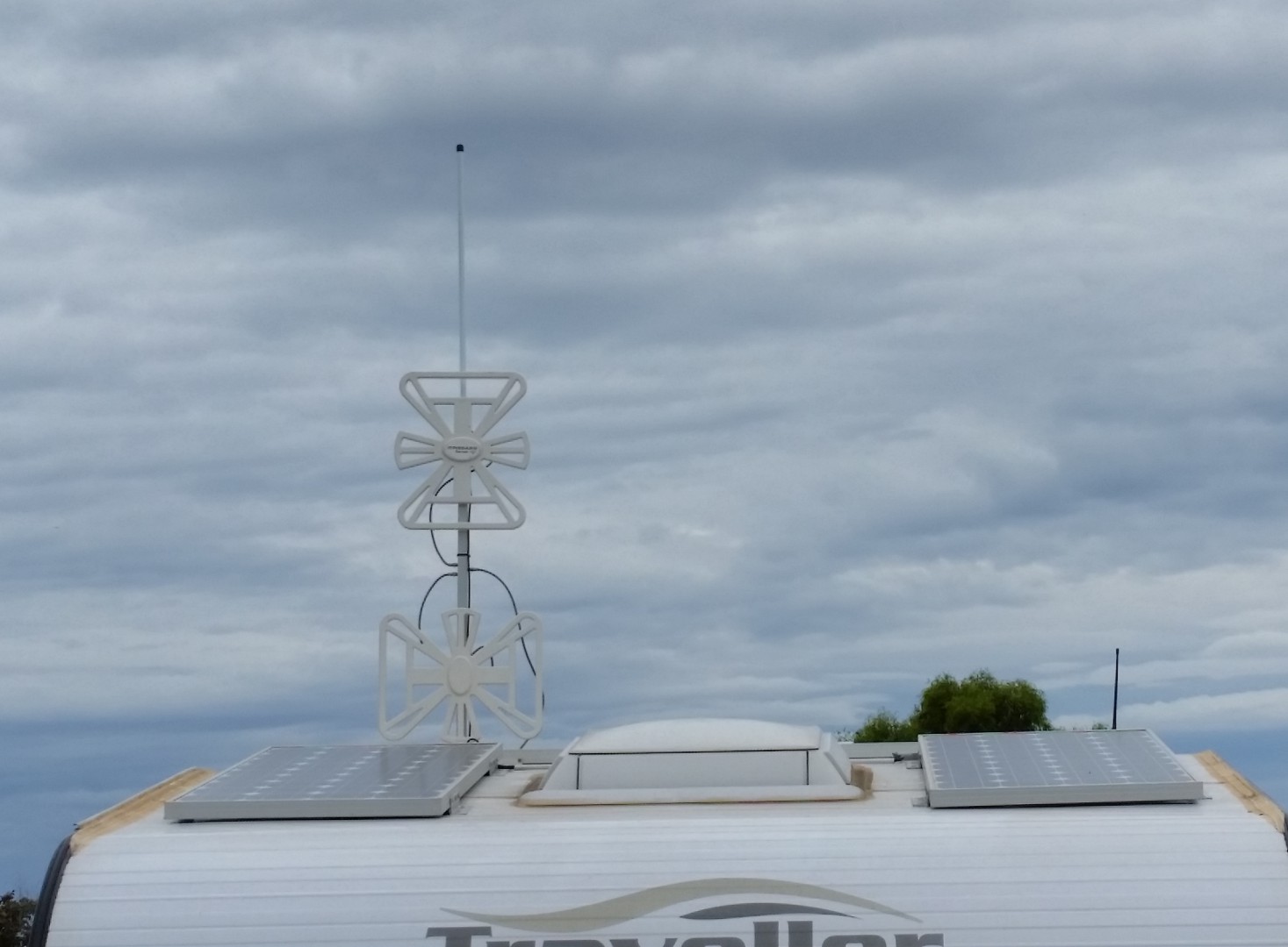

Olley46 said
03:05 PM Apr 12, 2016
This is what I use for Internet,I have a bracket on My TV antenna where this aerial fits so it is in the air,the patch lead screws onto the antenna lead and then plug into the modem,this antenna can be used for a telephone as well if you have an external antenna jack on your phone.
G'day Olley46. I have seen something like you explained. May I ask a couple of Questions? Hope so as here goes. 1, Is your Tv antenna a wind up type of fitted as you require it? 2 If a wind up does it add much extra load to winding unit. I wanted to fit one to my wind up Tv antenna but was told that the extra weight would damage the gearing.
Cheers Jack.
laurieoz said
09:32 PM Apr 12, 2016
This is how I mounted my aerial to the TV antenna. Have not problems winding it up Follow the lubrication of the wind up gears in the manual
LUBRICATION (Done 3-4 times annually) STEP 1: To lubricate the elevating gear, apply a liberal amount of silicone spray lubricant to the elevating gear with the lift in the down position (see illustration). Run the lift up and down to distribute the lubricant over gears. STEP 2: Two times yearly, or in the event rotating the antenna becomes difficult, normal operation can be restored by lubricating the bearing surface between the rotating gear housing and the base plate. Any silicone lubricant spray may be used. Elevate antenna and remove plastic plug from rotating gear housing as shown. Spray lubricant into hole and around edges of gear housing. Rotate gear housing until lubricant coats bearing surfaces and antenna rotates freely.
I have done exactly the same. The antenna is attached to the top of the Winegard with the cable down into an overhead cupboard where the modem sits permanently powered. It works well and is very convenient. I've not had any issues with the winding mechanism at all.
Don't know what those antennas are but the AREN'T mobile network antenna, wrong size. Though perhaps sold as a mobile antenna they look more like WiFi antenna.
Such an omni-directional antenna will have little benefit on the cellular networks unless you are already very close to a tower and it is only the metal box of your van that is attenuating your signal.
The data part of the mobile network is dependant on the carrier's equipment near your location and generation level of your phone/modem (2G, 3G or 4G) and could be 850, 900, 1800, 2100, 2300 or 3500 Mhz and the wave lengths are way shorter than those antenna.
For good reception at those frequencies you need a Yagi design that you point in the general direction of the nearest tower.
I have installed many of these for outer urban and country businesses that have been unable to get any other sort of broadband.
G'day. And thank you laurieoz and GerryP. My van is a poptop. When you ran your cables did they follow the same track as other cables and did it cause any interference with other? Do you use a wireless modem. I am thinking of running the cable alongside the Tv run and putting the modem under the Tv. At the moment I have a plug in dongle but if it all works going wireless. Cheers

Hi all,
Can anyone fill me in on getting and setting up an External Internet Aerial on my Caravan. I have seen others have done this but thought I would get your experience before I tackle the task.
Look forward to any replies.
Happy Travels,
Greg
Lance C
Cheers Jack.
LUBRICATION
STEP 1:
STEP 2:
rotates freely.
Here is a web site I buy mine from and has pictures of what they look like http://telcoantennas.com.au/site/rfi-12dbi-3g-4g-lte-yagi-antenna
