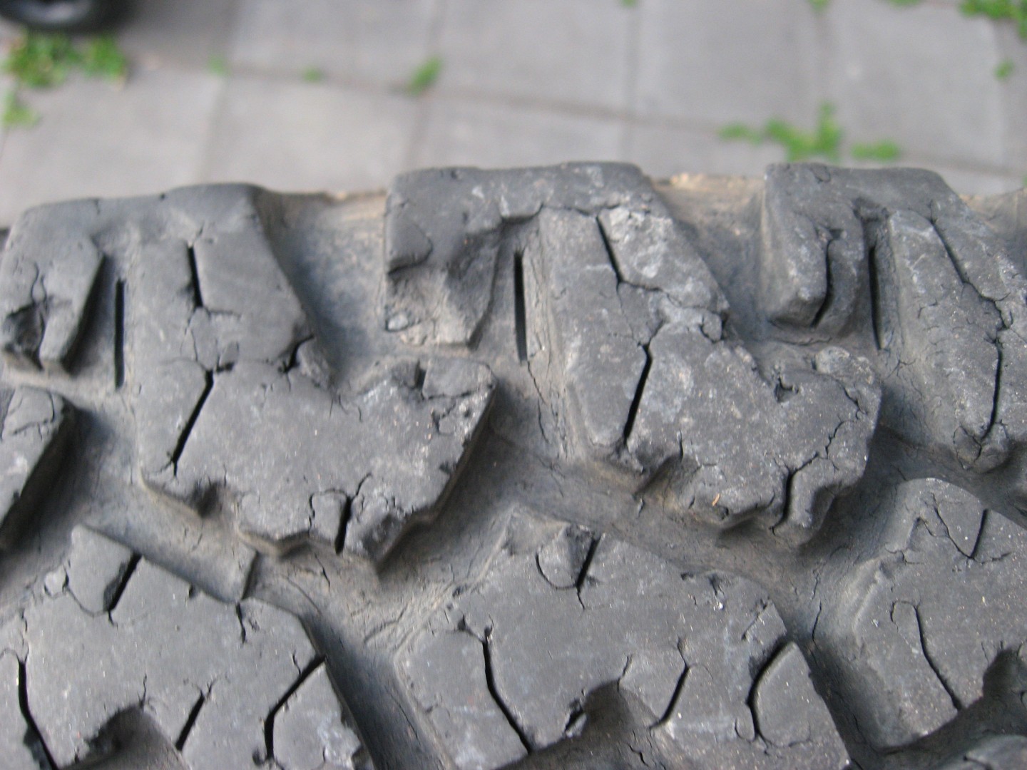

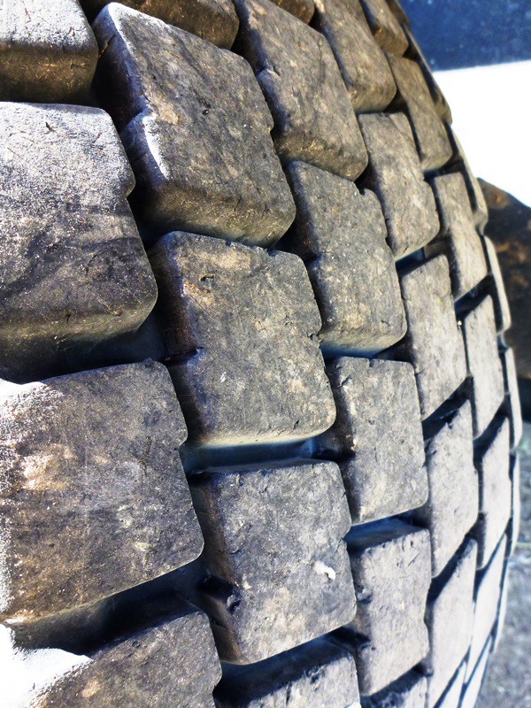

BFGs are good tyres. They chip more than some AT tyres because they tend to have a harder compound. They also last well, for the same reason. Chipping is a risk with harder compounds, but can be reduced significantly by keeping the speed well down. Chipping is typically much worse on the rear tyres than the fronts, I believe this is because the stones are often on edge instead of laying flat.
This is an extreme example of chipping after a high speed run up the Strzelecki and down the Birdsville. It was all driven in 4WD.
Rear tyres...
Front tyres.
