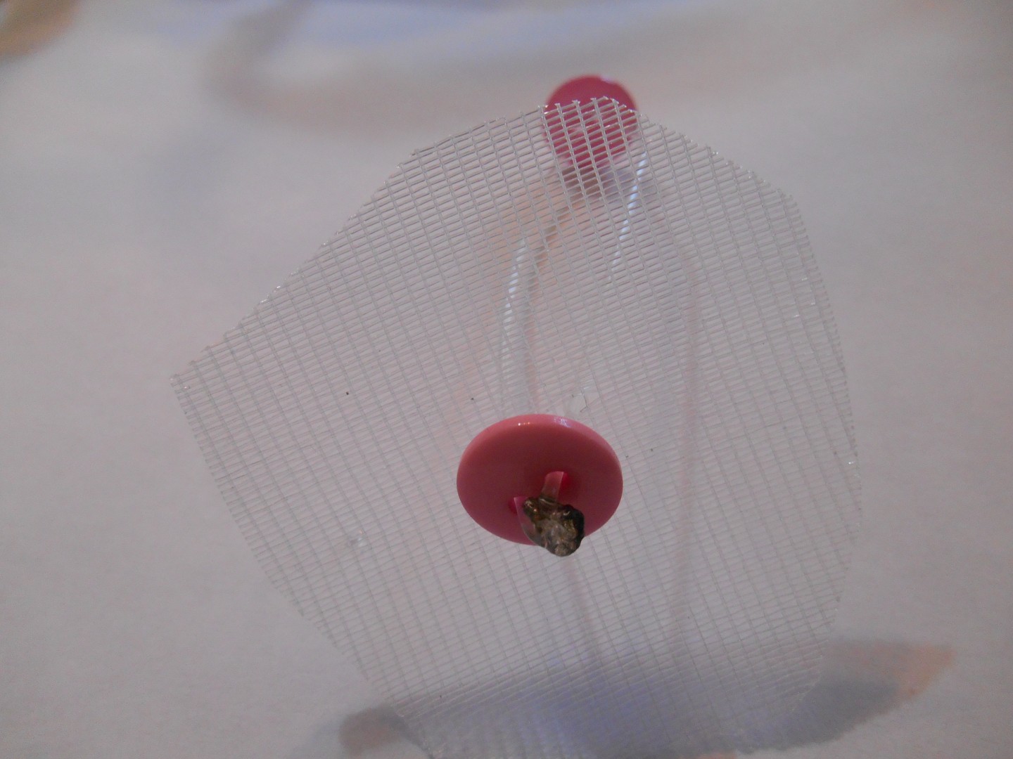

After looking around for a 25mm commercial Sink / shower Strainer. I played around with this idea to stop the bits flowing into our grey water holding tank when used.
Using two small buttons 150mm of heavy mono fishing line. 1 x Kmart soft set of three strainers =$3.50
I cut out the nylon mesh pushed the line through the two button holes, through the mesh, through the second button. use a match / candle and melted the line back together.
This way the lot gets pushed into the sink drain fully. put the plug in and when finished pull the plug. Waste water drains out, grab the top button and all the leftovers are retained. washout ready for next use. A few photos attached.

From other GN's with and with out holding tanks they have had issues with the smell coming back up the pipes into the van because of matter getting hung up in their systems. Our van has Hypo filters fitted in line to stop the same odours. I'm also trying to avoid small food scraps / body hair etc from getting into our system from the very start. (Prevention is better then the cure.)
This unit can be pushed completely into the line by drawing the two buttons together the mono line is 130lb and stiff, to allow myself to push it down pass the inserted drain plug so it does not interfere with the plug in any way. Its very quick to put together. I must admit it's very novel,simple, but should do the trick. Yet can be drawn out with a pair of small pin nose plyers, or your fingers by pinching the melted nylon bulb and drawing it out, without getting hung up.

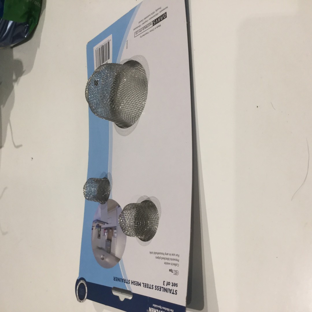

Is this what you were looking for ?
There are 3 strainer sizes in the pack, 20, 25, and 45mm in diameter.
$2.50 the set at my local variety store....
Let me know if this is what you want and I'll organise a set for you
if you like.
