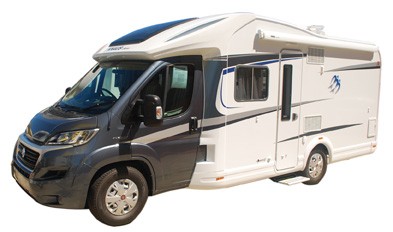

Thanks guys and yes peter some info would help. It's a Knaus Skywave 650mf and that's correct 80 psi. Checked everywhere and it is correct. I have a little 12V compressor Aus-Kiwi and it's rated up to 300psi but do they really do that. Used it once to pump a car tyre to 30psi and it worked ok. But 80 is a bit different

My brief searches suggest this vehicle has 215/70R15CP tyres fitted. Is this correct? Are the rears single or duals?
Those tyres have a load rating of 109, a maximum load of 1030kg each at a maximum of 65psi.
All of this information will be on the sidewall of the tyre. Please check it.
That vehicle also has a maximum weight of 3,500kg. Do you know what it actually weighs, front axle and rear axle separately?

Single rear axle and they are 225/75 R16CP. Fully loaded with everything in it I put it on the weigh bridge and it was 3800 kg. It's rated up to 4250kg.

Can you read the tyre maximum load/pressure information written on the tyres?
You are 400kg below the maximum weight of the vehicle and the tyres have a max load of 1250kg each (5T for the vehicle if all loaded fully).

The tyres are stamped on the side ( very small writing ) for 80 psi.
