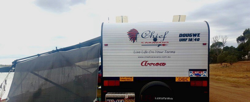

It's not just the fine Warren, you lose points as well, 3, I have been told.
I spoke to the police late last year and they told after a discussion with a traffic cop as well that they have much better things to do than book people with a slightly high fitted number plate BUT if the owner started arguing then out comes the book and pen.
They told me it doesn't matter where I fitted it as long as it was of legal height, visable at a 45* angle left, right and above and was lit up at night. After the discussion I proceeded to solve my problem....
Hope your right Doug. I have 3 coppers in the family ( vic ) and while I haven't asked them about this I know they hate wasting time on senseless issues. but still I think I had better take a leaf out of your book and drop the plate a bit. not as though I haven't got time on my hands.

We have only heard about this issue a few weeks ago. We contacted ou manufacturer ( kedron), tey are sending out a kit free of charge to remedy. But, we were surprised there had been no correspondence from them prior to this point.
Dunmowin
how old is your van ?
It is amazing that you can pick up the leading caravan mag the writers go on to say the tap is to low or power point to high but there is never any comment about the number plate height.
My 8 year old caravan is illegal, oh my gosh.
Maybe there is a chain of responsibility here.
