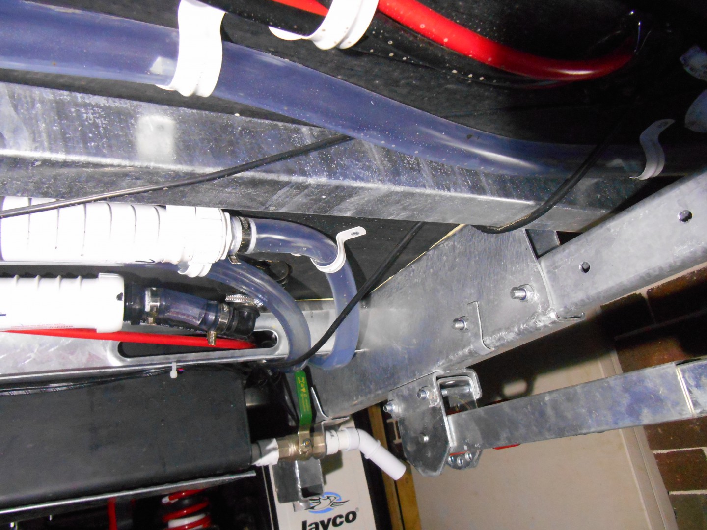

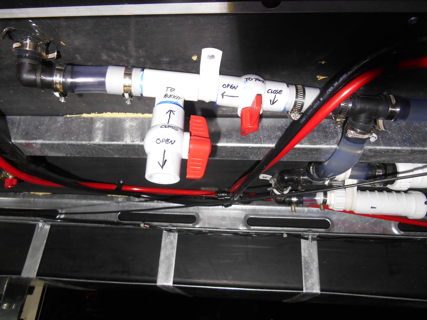

I completed this on Thursday before the poo set in again. I added a By Pass to our tank setup from the kitchen sink as follows. I have the space to move the front 75lt water tank back one frame away from the draw bar.( Not done as yet) I went to bunnings and brought two 25mm ball valves one 25mm tee junction, 1 mtr of 25mm pipe, 2 x extra S/S hose clamps 1x pipe glue.
Now we have two options, the sink can By Pass the GW tank to stop the smells before they start, direct into a bucket or attach to a GW hose as well, Or Continue to the tank as intended.

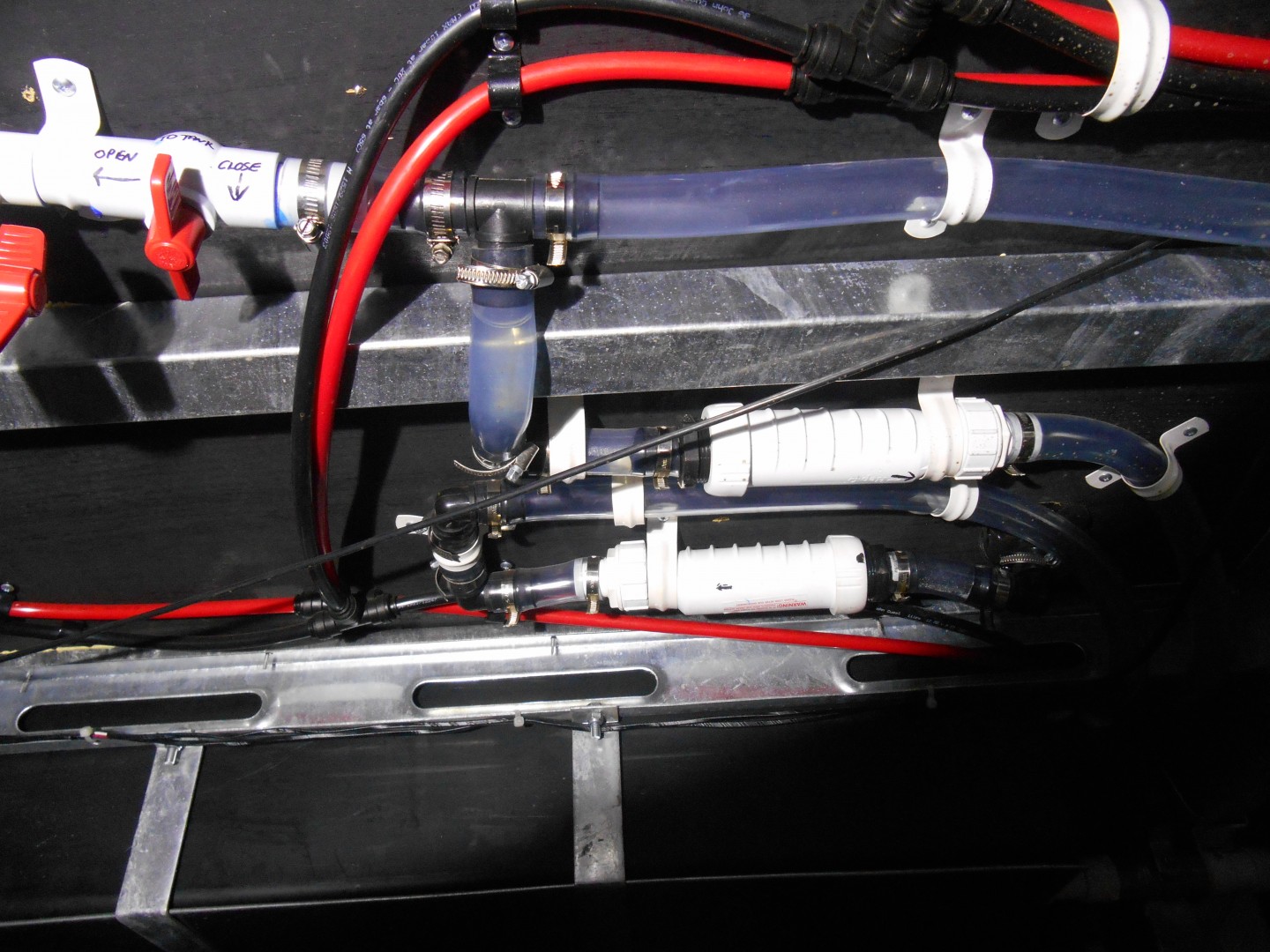

There are two white looking Filters clamped to the floor as well. I'm not sure If they are in fact filters as they will be a PITA to clean.
The biggest issue is the gravity flow for both the shower and sink as there is about 150mm MAX from shower inlet to holding tank with a uphill 100mm bend inline to over come which will leave only about 50mm at most for the water to drain away. Not good at all.
Hi Jim,
Those 'filters' are actually one-way valves which act similarly to a 'P' trap.
They normally do not require cleaning and stop any smells from going back up the pipes and into the van.
See here >>>>>> http://www.hepvo.com/

Hi Jim, looking at your photos the hepvo valves seem to be upside down. I don't know if it is a trick by the camera angle or not, but the ribbed side of the valve must be underneath when in a horizontal position. Check installation instructions on the hepvo site.
Barry

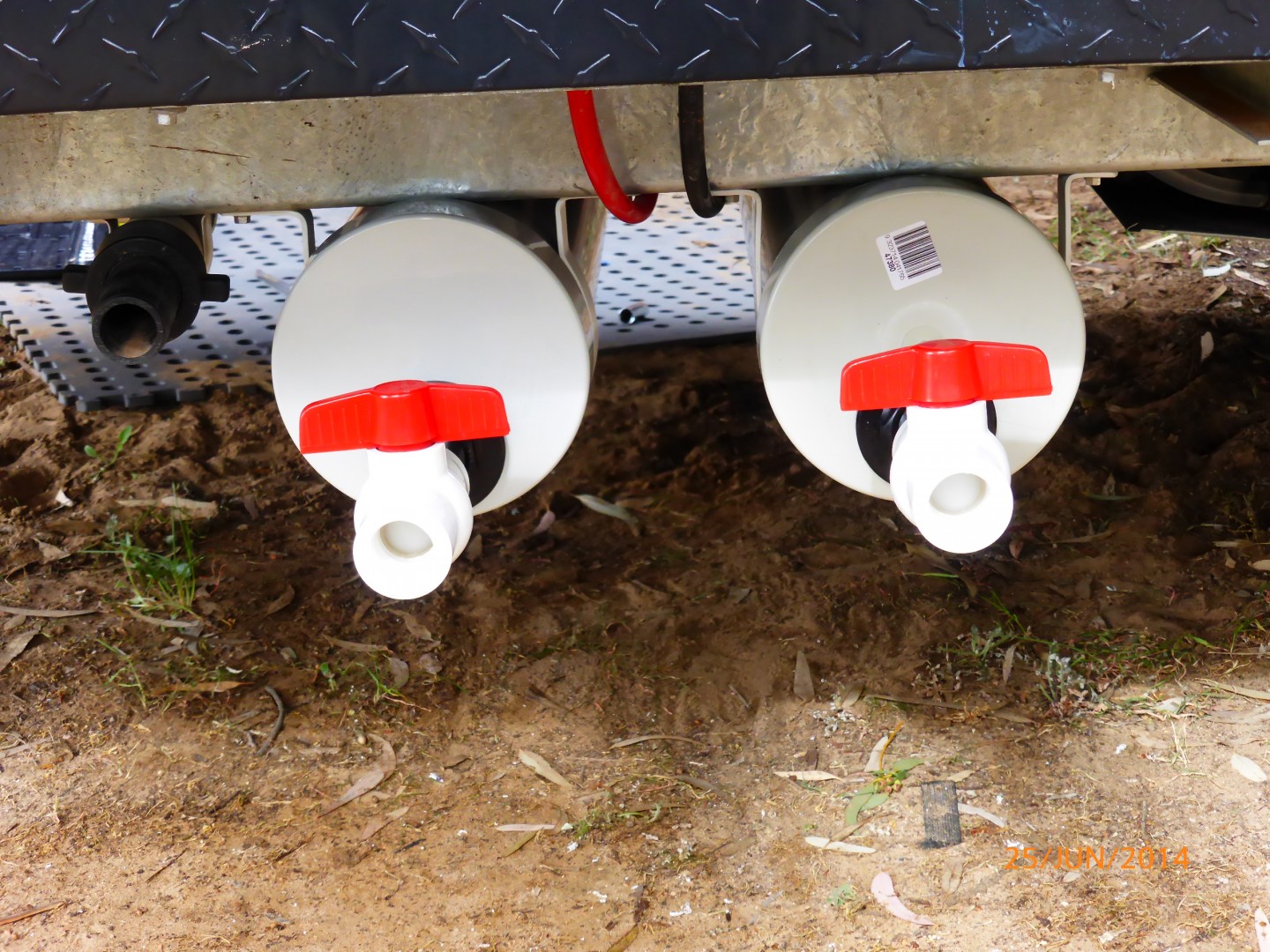

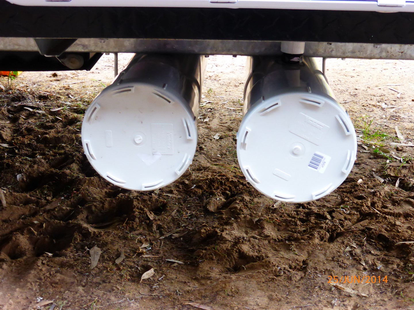

I find it difficult to comprehend why someone would be traveling with grey water in their holding tanks. There is no need to carry grey water in your tank at all, sump options and the availability of dump points counters the need to transport grey water. As well, in the back blocks you do not awash the camp site but gently drop the water out on the exit road etc.
I have in the past displayed on this forum a grey water system that is now nearly 2 years old traveled well over 40, 000 klm, does not smell, does not back up showers or sinks, can be cleaned/accessed using a karcher spray cleaner and makes the JAYCO Outback fully self contained and compliant with "Leave No Trace".This system allows us to stay in Club Car Parks, our daughters front drive, and countless free camps without creating a sloppy mess.
You do not need to be putting out black hoses, moving grey water into other alternatives and making life complicated.Mind you there are a few members on this forum that I think may have not much else to do any way, and may be happy to occupy their time emptying containers of grey water.
I loved your idea and saved it John BUT had laptop crash and lost some data including your grey water fix. What diameter are the pvc pipes? I imagine 150mm? Thanks for sharing again Mate.

Hi Barry,
It's not trick photography. YOUR RIGTH the bloody things have been 1 x turned sideways 1 x up side down to make them fit snug against the floor. Bloody JAYCO.

Is this what you mean Barry?
Thanks Aussie Paul,
I will be taking the Instructions with me back to Jayco.
see photo's attached.
Check the system out once again:::::
