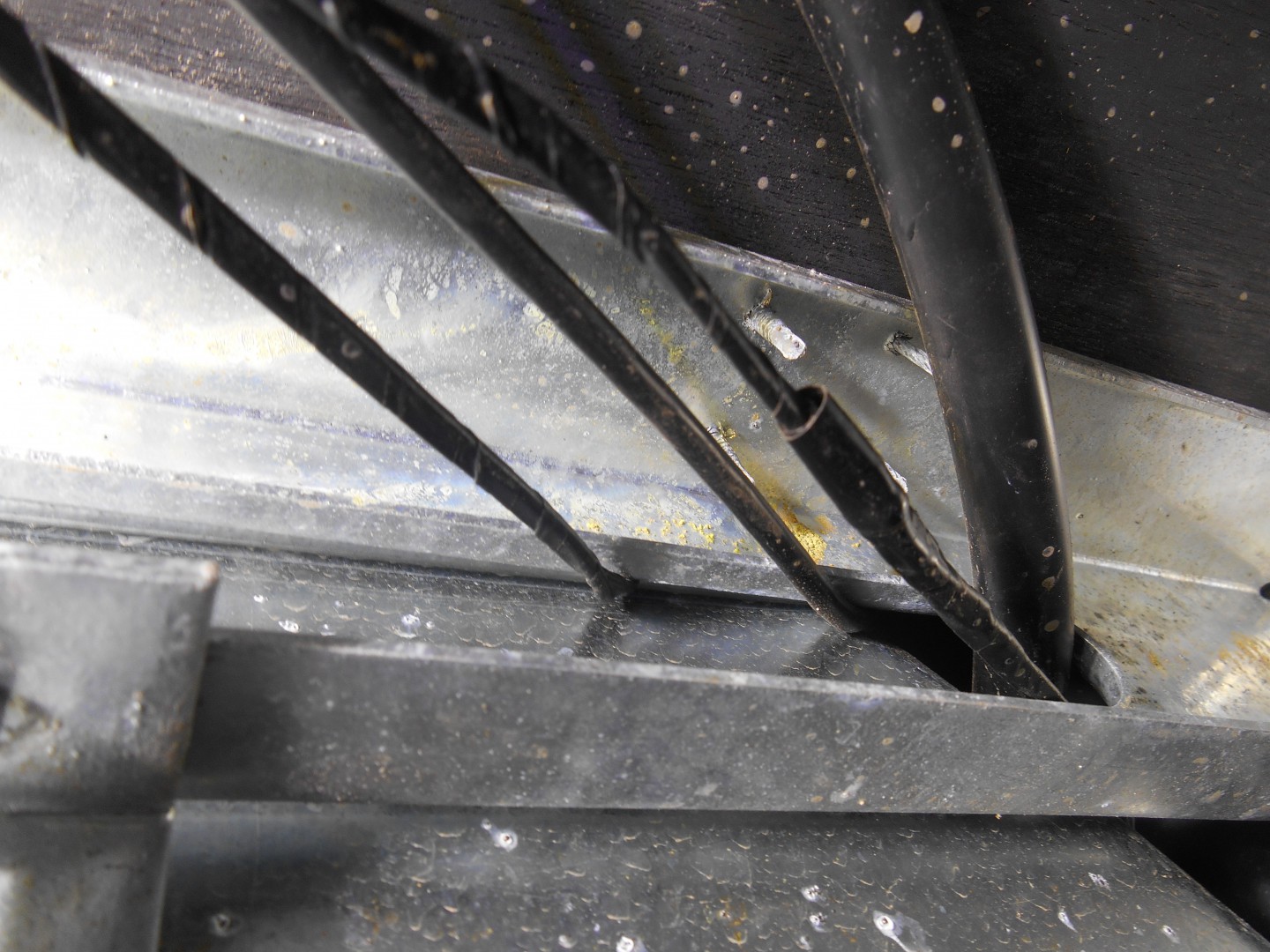

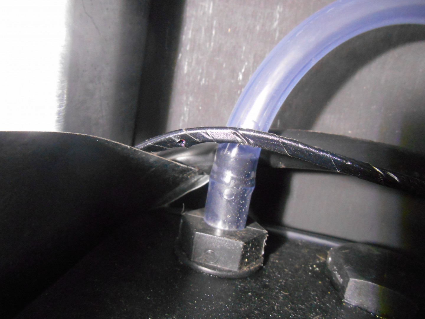

I have been under our Jayco Journey outback which now completed 80km to St Mary's Return. It has not been out of the garage till this week. So that we can prepair the van with all the extra's we want to install and rectifying the issues we need to fix. I covered the brake leed wires to protect them yesterday. I got to the grey water tank to cover the wires just now that also needed to be protected, that I imagined ran through and around the cover plate around the tank itself.
To my Horror the grey tank has been installed crushing the two seprate sets of wires.The protective plate that protects this tank has cut into the plastic sheath around the gas line that runs to the gas stove and has started to do the same to the + & - wires next to this.
To protect my wife and myself We are forwarding the email we send to you to backup our phone call this afternoon to your service staff member Anneke, on to our insurance company NRMA.
It sends shivers up my spine as to what could have happened if we used the gas stove. Im attaching photos.
