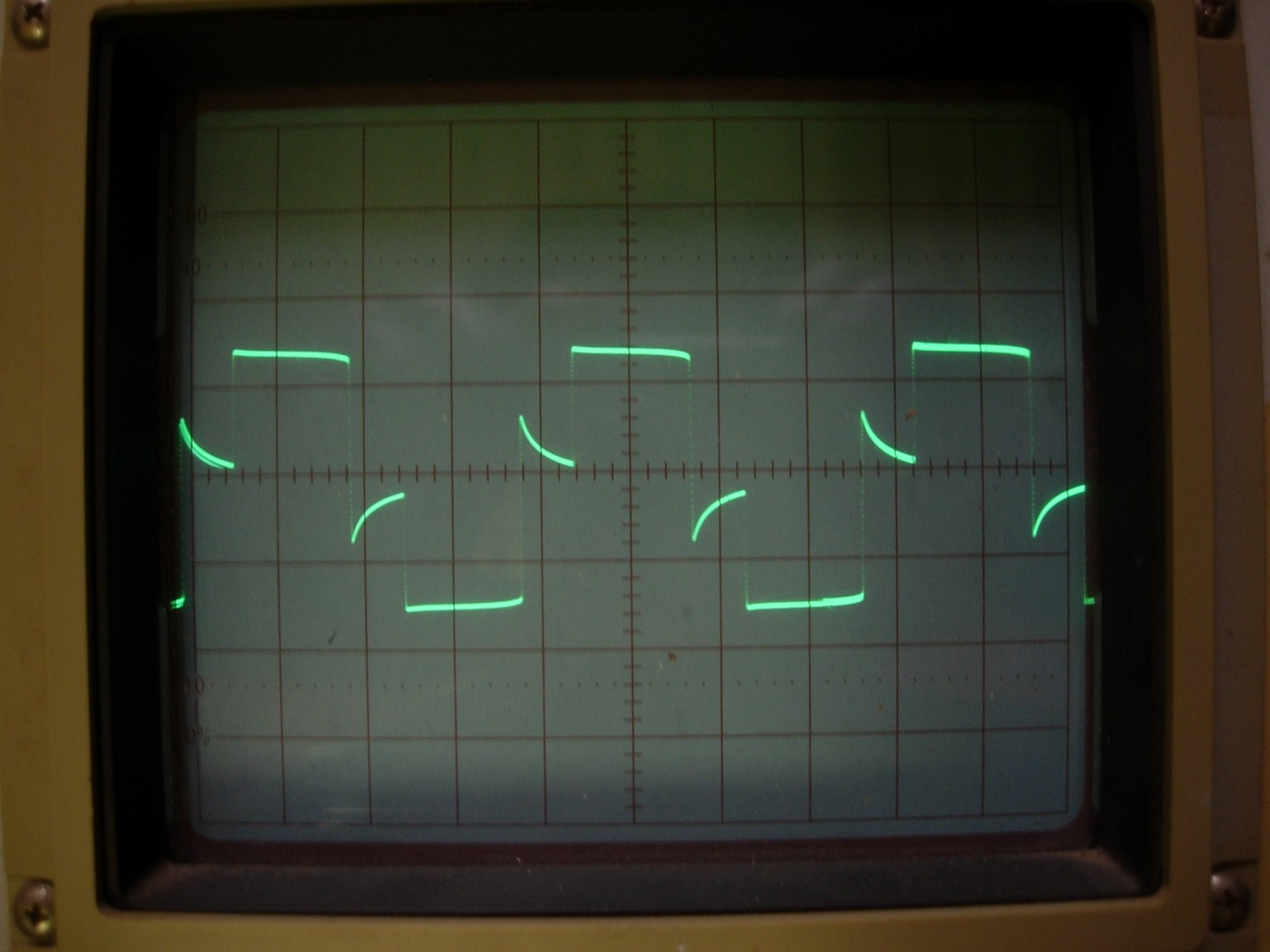

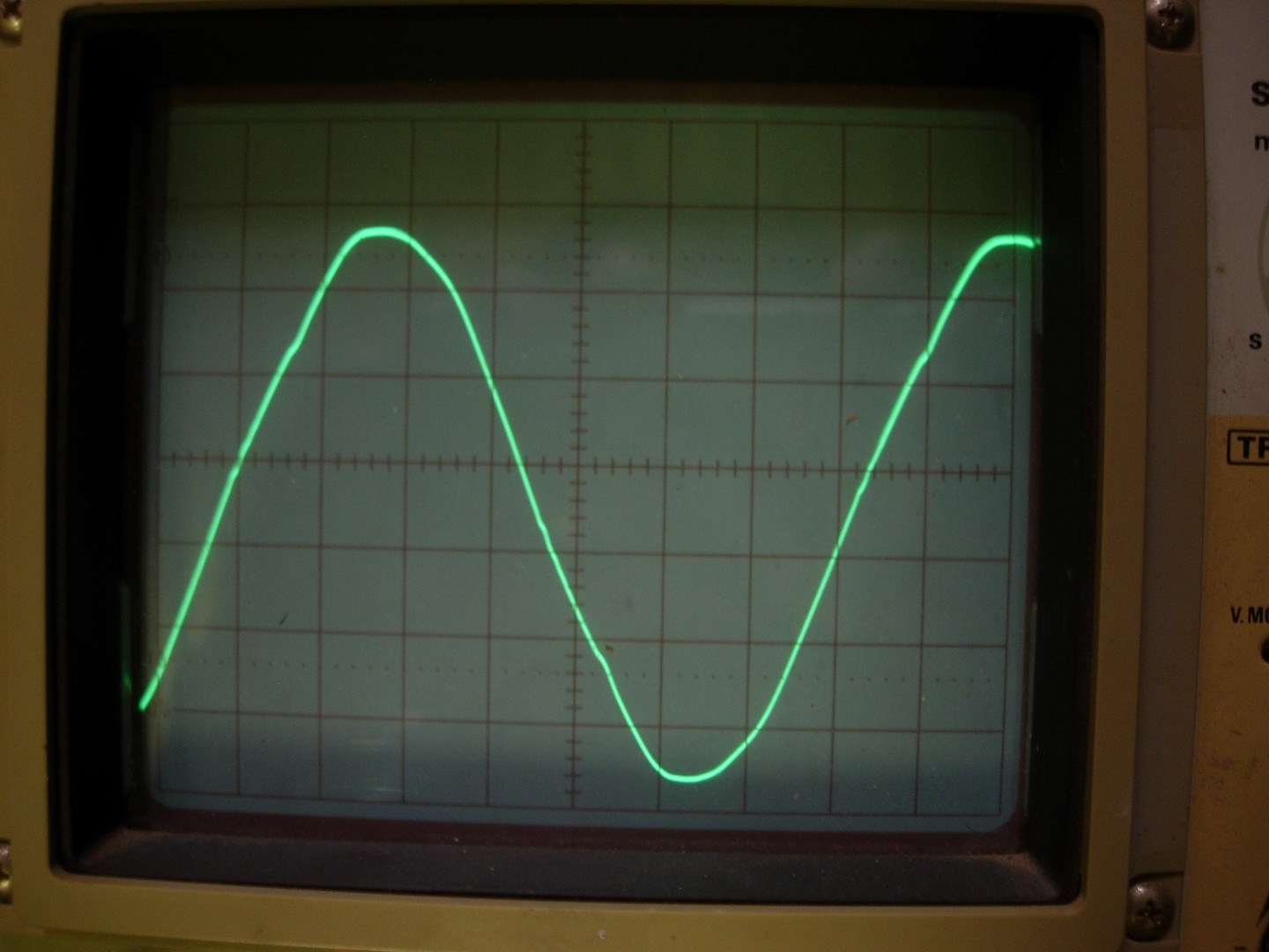

This is the Wave forms fed to the Engel compressor, about 20V & 50 Hz. The square wave is from the 12V drive, the sine wave is from the mains.
Hi DB
Thanks for those Scope wave forms
They verify what I posted ,that the DC current draw is not constant DC, but pulses at Approx 100 per sec which a DC Ampmeter cannot read with any degree of accuracy.
& since its form at the compressor is Square wave , not sinusoidal AC, using the AC ranges there ,the readings would be even worse.

DeBe said
08:21 AM Mar 15, 2016
Un able to check on that as I dont own an Engel. That was taken on one I repaired.
