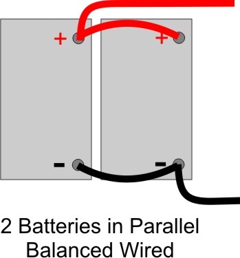

madaboutled said
09:40 AM Mar 9, 2016
A picture tells 1000 words....
Note that the Power Out Cables are coming from each battery, first battery from Positive and second battery from negitive. This will force the draw and charge to be equally distributed between both batteries (Balanced).
