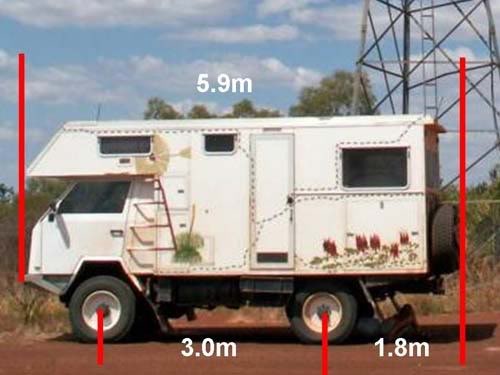

You need to be very careful with the overhang. The rules state the overhang from centre of rear wheel to back of MH must be less than 60% of the distance from centre of front wheel to centre of rear wheel ie wheel base. This sounds a lot but as an example on a 25ft Jayco I cannot legally have a 600mm tool box on the rear. I know you see a lot of MH with big boxes on the rear end but I believe they are illegal and I wont take the chance with insurance companies. The attached file shows the rules

Our OKA is right on the limit of maximum overhang.
Thank you that photo explains it all to me, being a woman when it comes to the technical stuff I am not the best lol. This explained it all in a simple way. Thank you again so much
The 1.8m of overhang is 60% of the wheel base.
