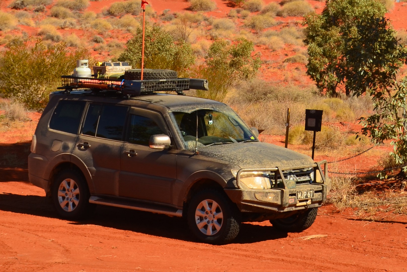

Daz hi, I am currently using the Rhino basket & having tried others would recommend the Rhino, certainly if You intend to use a few times on the type of roads leading to the Simpson. Have crossed numerous times Its roads leading to it that usually does the damage. The roof top mounting is as important as the basket. If Your bars are mounted to the factory fitted fore aft rail type would seriously look at replacing. My current vehicle had those & were useless went back to track type which IMO is the better way to go.
Surprisingly the weight as can be seen there amounts to about 140 kg when the two gerries are full which is above the recommended.

Remembering that it is always a good idea to add extra weight high up on any vehicle. It really assists the vehicle dynamics in the event of an accident.

On this occasion I must agree with "The Phantom " not to mention messing badly with the fuel economy
