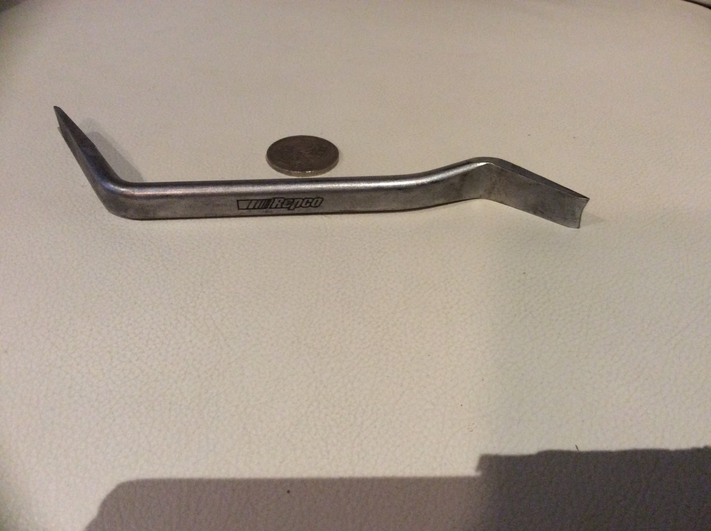

Hey Jim
I think this is the tool you are looking for, I got this from Repco.
After I finished mechanics training in 69, I bent a screw driver, about 8mm wide blade, same shape as the tool.
I still have it and use it on the van, sister in law's horse float etc etc and handle is easy to hold.

I have 4 different brake adjusting tools, the main one is like the pic but with about 3mm ground off each side to make it narrower on one end, another is a small bent blade screwdriver. the other 2 have been made for a application neither of the first 2 would do. Also be mindful that a lot of adjuster have a lock to stop them undoing (its real purpose is auto adjuster).

That tool, as pictured above, or similar can be obtained from any car parts place. Not expensive.
I have one and use it successfully, but have also done the job with a simple every day screw driver, but a good small LED torch is useful, to peer in the slot.
In case anyone is not aware, elec brakes should be backed off about ten or a dozen clicks on the adjusting wheel. The handbrake when hard applied should be in about the sixth notch to avoid brakes snatching on and off whilst travelling, but you all knew that!
