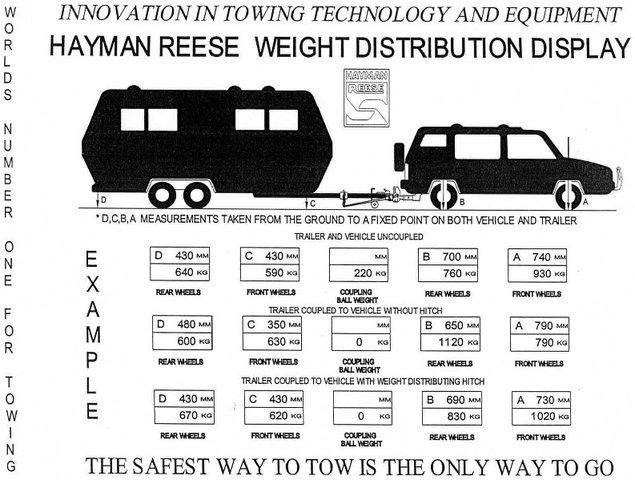

03:32 PM Mar 1, 2016
Woody n Sue wrote:
HOWEVER as a point of interest has anyone ever put there tug on a weight bridge weighed it with the van unhitched and the van wheels not on the weigh bridge obviously , then hitched up the van with there WDH and checked the weight of the tug this would be the ONLY true way to know how much weight is being applied to the tow ball .
Hayman Reese often spend all day doing this at caravan shows. The JPG below is the result from one of the shows. Do a little maths and you will note the weight on the vans wheels increases and the total load on the tugs wheels decreases when they hitch up.
Also calculate the change of weight on the tugs rear wheels. Most people don't realise how much weight is transferred to the driving wheels id WDH is not employed. I would suggest that a lot of vanners are overloading their rear axles when they don't use WDH but would be OK if they did use it.
Just trying to work out how those measurements above were taken, If we take the weight D and C, then the only way to measure them would be to raise the van off the ground, and take those 4 measurements, then how did they get the ball weight which would be the result of moments from the fulcrum point, i.e. the axle?, because the axle would be off the ground. Just cant get my head around how you could measure D and C with the wheels on the ground.
Further if you add up the CVM in the last row, they forgot to add the weight of the hitch, in this case 275kg hitch 30.5kg. Which would take the CVM from 3140 to 3170.5kg. This was my original comment at the start of the post.
I don't suppose Haymen Reece sell weight distribution hitches do they?
On the comment I made about the ball weight of the tow bar, I have come to the conclusion its all Ball or Bull-****. The towing capacity of the towbar is 3500, now what's 10% of that ,Oh! its 350 how silly of me.
OK bull dung bull dung bull dung, got it!
-- Edited by iana on Tuesday 1st of March 2016 06:42:12 PM

08:28 AM Mar 2, 2016
HR use 9 load cells, one under each wheel and one under the jockey wheel. I have seen this exercise demonstrated at the Sydney show. Yes they have their towing gear on the same display stand. There is no slight of hand, they are just demonstrating how their equipment works.
Don't attempt to make any conspiracy theory about this subject.

iana said
05:39 AM Mar 3, 2016
Talking about pies, I am wrong, I didn't read the "rear wheels" "front wheels" under the chart, but took the weights to be taken at "D" & "C". Load cells under each wheel would give these measurements.
The dynamic situation provides a better environment for the analysis of the difference between weight and mass.
