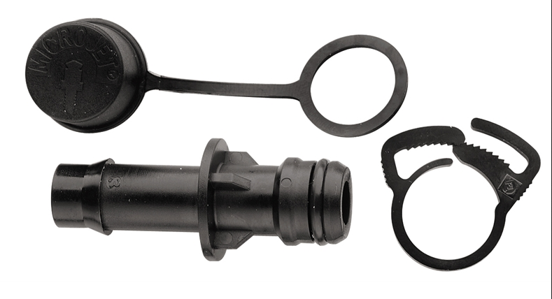

Even when you have the breather tubes clean and clear you can get air locks in them after filling your tanks. Many of us have a short length op hose with the fitting pictured below on one end. You click this onto the water filling hose and stick th free end down into the filling hose through the water inlet. This is enough to blow the breather tubes clear.
Just an update on this, I had to re route the filler hose inside the cupboard and created a very slow fill process.Couldnt get the normal 1/2'" hose far enough into filler and created an almost airtight fit. I then found some 10mm or 3/8" clear vinyl tube, less than 0.5 metre needed, so dont go to the funny green shed as they want you to buy 5 metre prepack at outrageous price. Try an independent irrigation outlet. $0.85 cents per metre. You will need a 13mm to 10mm joiner. Philmac HJ1210 is an example. Bit smaller tube then fits easily and doesnt restrict the flow very much. Another nice touch is to put a "greenback ' tap which allows flow adjust, or OFF to change tanks, or to check tank level.
