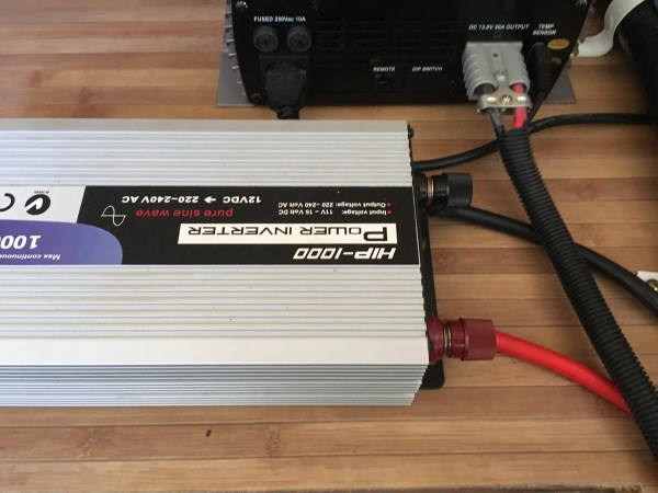

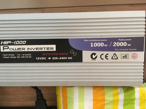

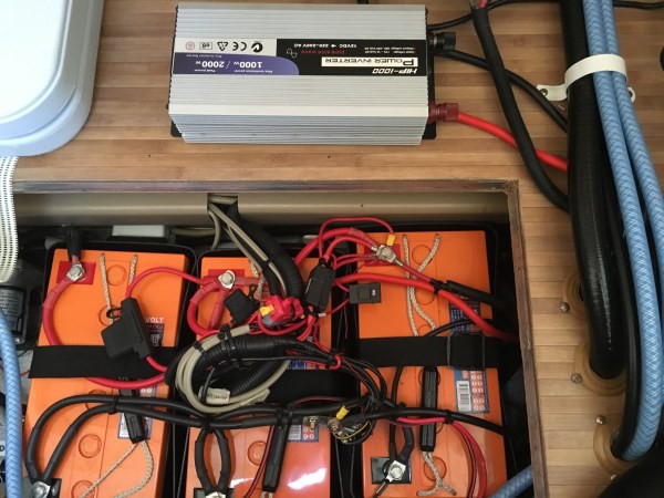

Just purchased a 2000w pure sine wave inverter . Do I need a fuse between it and the battery bank and what size fuse if any would you recommend. Would have read the instructions but it didn't come with any , (second hand but never used).
Thanks
Mick
What is the brand and model number of the inverter Mick?
You need a 200 amp fuse between the inverter and the battery and use battery cable to connect it all up keeping the inverter close to the battery as possible jaycar sell the fuse
Dragonfly1
Not necessarily. If the inverter is internally fused like the Projectas, and it is fitted within a foot or two of the battery (which is the better idea), using something like 1 or 0 B&S cable and no likelyhood of the cable being damaged by metal edges, then the internal (12 X 20A fuses in the Projecta) will suffice.
No point in theorising anyway, till the OP gives some details about which inverter he has.
1000w is the continuous rating
2000w is the peak power for a short time (eg motor starting up )

Hi If you put something there I suggest a circuit breaker instead of fuse. Good idea, what have the other loads got now ?
Look at these on ebay. They would cover a good load on the invertor but not the full 2000W.
