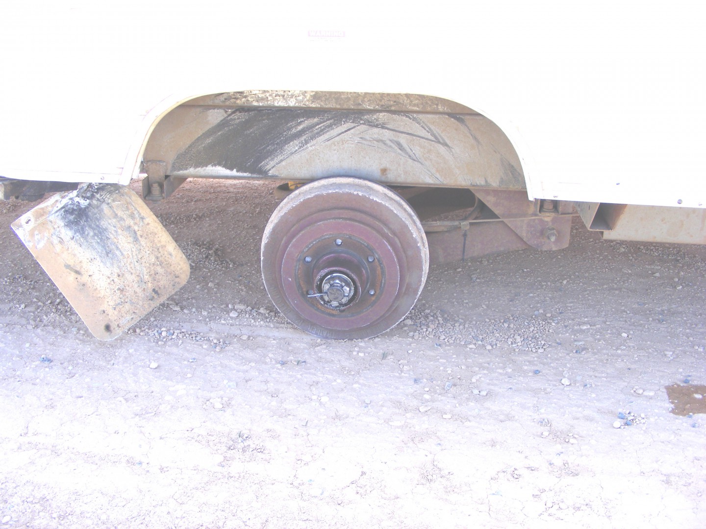

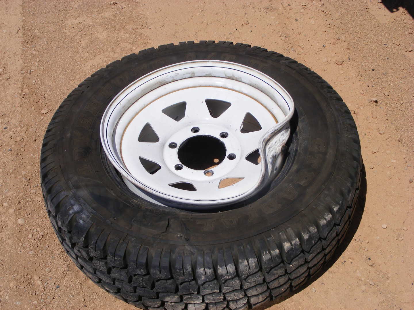

Know all about stripped wheel studs on van!
Photos show the result of studs sheering off.
Had a new tyre fitted in Esperance WA and nuts were torqued to the recommended 110nm.
A couple of days later, 360kms west of Norseman, the wheel parted company with the van.
RACV Total Care to the rescue (never leave home without it); van was flat bedded the 360kms back to Norseman where repairs were made.
General consensus was that the weight of the van was being borne by the studs, rather than being borne by the hub.
Replaced both sets of studs ($5.60 ea.) and nuts ($2.00 ea.) and had spacers made up and fitted to both hubs; the weight is now borne by the hubs, not the studs.
New wheel and tyre cost $350.00.
Seems to have cured the problem as nothing has fallen off during the 6000kms travelled since.
