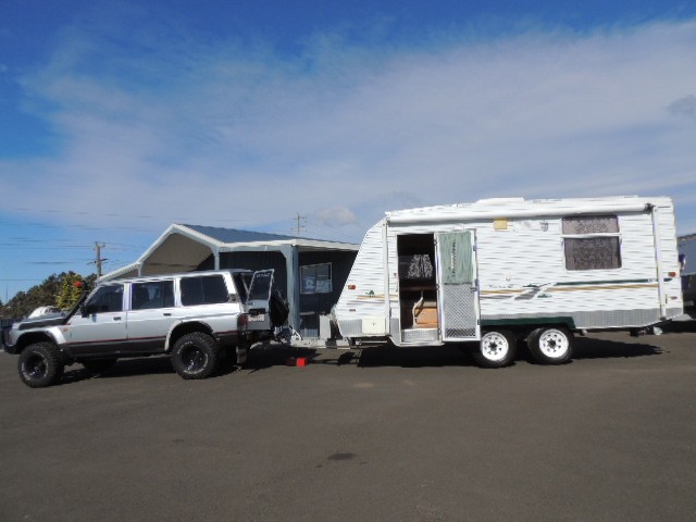

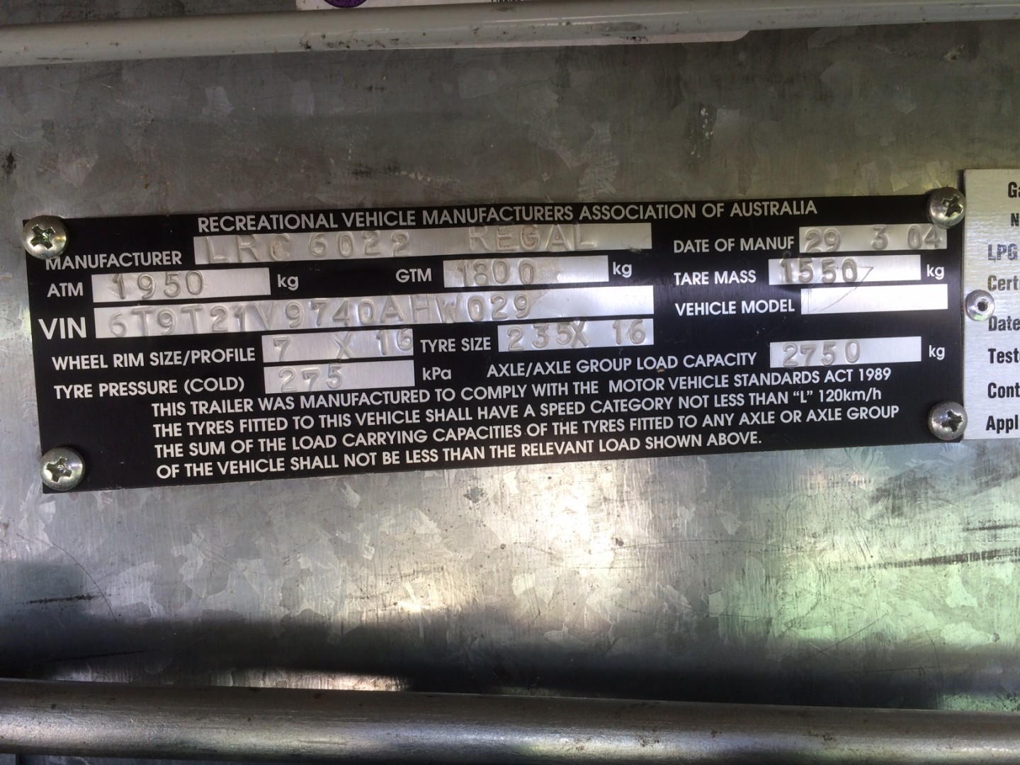

I'm in big trouble here
We are off to QLD in the next fortnight for a five week trip and....
.....and the problem is....
Weighed the van at the weigh bridge on its own --- 2280KG laden with water, gas, food and clothing + only essentials for the trip
Combined weigh - Mav and Van = 5001Kg (Laden - Mav 2721Kg = 29Kg below NSW Rego GVM - without us occupants)
Tow Ball weight 165Kg
There is no GCM in the handbook of the Mav only towing capacity braked at 2500Kg
We bought this van July 2014 and only added food and clothing + BBQ webber + table + sullage hose + water hose + tools and spares (10Kg) +ground cover
I am now thinking this van was over weight when we purchased it.
The compliance plate may have been correct in 2004 so between then and now I have no idea why the increase as what we have added of our own would only total 120Kg +/- a kilo
Only thing that seems OK is the Axle/Axle Load Capacity ??
-- Edited by Vince on Thursday 18th of February 2016 12:00:03 PM
Ford Maverick is not listed in the Towing Mass Guide but should be the same as a Nissan Patrol which has a GCM rating of 5600/6200kg so you are OK there.

Jaahn said
04:00 PM Feb 18, 2016
Hi Vince
The trouble is the b*st*rds in this business have been corrupt for many years and have regularly cheated on weights and figures. They thought no-one cared if things were "a bit over" which was largely true and with some people still is a fact. That is why the state transport authorities are actually weighing vans and MHs now. Taken them a long time to get around to it.
Perhaps the current trend for GNs to travel at the maximum limits has made the situation worse too.
Sorry that you have got caught out. Looks like a visit to an engineer for a revision of the plate weights.
I think I would take a trip to a weighbridge first up when I buy something now.

Peter_n_Margaret said
05:08 PM Feb 18, 2016
Because the axle group capacity has plenty of spare, it may be possible to get the ATM increased.

TheHeaths said
07:35 PM Feb 18, 2016
Vince,
Not doubting you at all, but what I suggest is this.
Empty the van totally, including water tanks and HWS if fitted, but don't worry about the gas. List the various options fitted like Aircon, Awning etc, then go and get van weighed at a certified weighbridge. When you get it home, refill the van, but weigh each and every thing you put in the van. Load it as if you were going away, and keep a sheet with all the items and their weight on. Then you will need to add the weight of water (1 kg per litre, so 2 tanks if you have them could add 160kg or thereabouts), the HWS (possible 23 kg if a storage unit), gas if full would be 9 kg per bottle, and then see what the total weight is.
Certainly the weighbridge figure will give you a good idea how much the Tare is understated, if at all, and it may surprise you, especially if aircon, awning and other options were added by the dealer instead of the factory.
When you have all the information, then approach the builder and see if the ATM can be increased to better reflect what you will weigh when travelling.
Good luck.
PS we weighed everything when we first filled our van to get an accurate figure, then added water etc to get a good guide. Then we did get an ATM upgrade from JAyco to 600 kg load which gave us plenty of wriggle room, as with 2 full tanks we cart about 460 kg of "necessary" (at least Kathy tells me it is) stuff!
Vince said
12:59 AM Feb 19, 2016
Hi
Montie - Weighed on its own unhooked and I was taking it that a 4.2 GU has a GCM listed and as mine is similar hopefully it will be right.
Jaahn - That is what I will most likely do - Get it re-engineered to the new weights revisions
Peter - Yes has electric brakes and it now will have to have a breakaway system added - got a quote of $700 which seems a bit extravagant
TheHeaths - Yep I will do as you have posted before getting it re evaluated for weight revision by an engineer - costly exercise but we love the van and so be it
Thanks for replies and advice
Vince
montie said
08:07 AM Feb 19, 2016
Vince, As Peter said you have a good opportunity to upgrade the ATM to the axle group rating. You will probably require the services of an engineer as Regal is now under different ownership. I would need to know the exact model to get the correct GCM rating because this could become an issue when you upgrade.
At the end of the day the only weight that matters is the fully laden measured weight ready to travel which must not exceed the ATM rating or the tow capacity of the tug. In your case you will be restricted to 2500kg which you say is the Maverick tow capacity.
Montie (keep forgetting my new handle)
-- Edited by montie on Friday 19th of February 2016 08:09:33 AM
