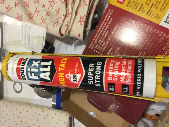

HI, everyone needs a tube of this glue, similar to Silicone and a 1000 times stronger, it will not let go and sticks to anything, about $14.00 at some hardwares
Regards Chris
