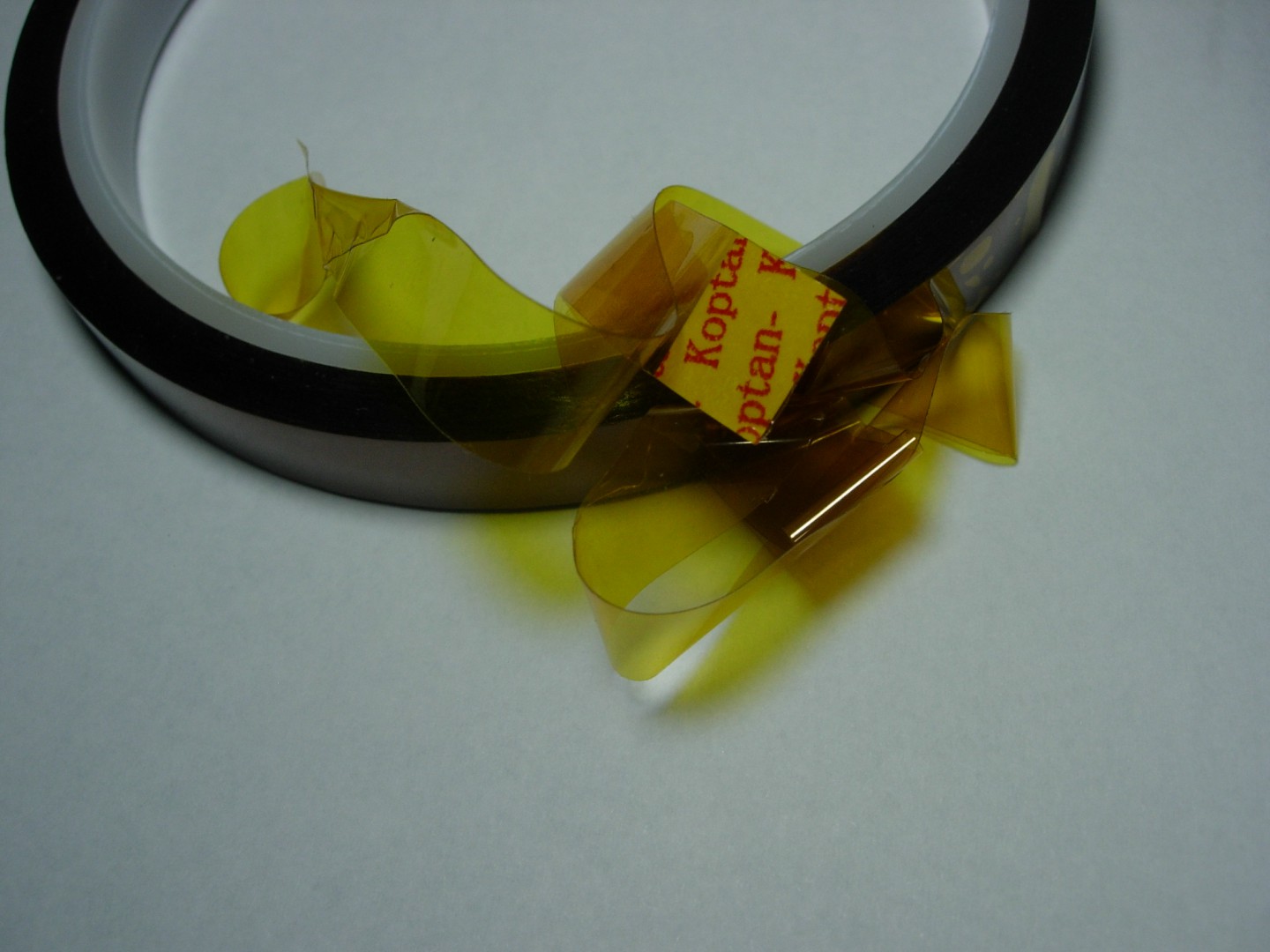

Unless of course it's this stuff:
Which is PTFE tape, or Teflon tape. High heat, very strong and great electrical insulating properties and is much thinner than standard PVC tape. We use to use a similar tape on aircraft, and I still have the odd roll or two in my tool box. It's still a dodgy way to connect the wires though.

Interesting name on that tape Darryl. Very similar to Kapton, which got big news in the aircraft industry a few years back. It was very good tape till it got a few years old. We used to have a few dramas with it on the F-18's
Kapton
