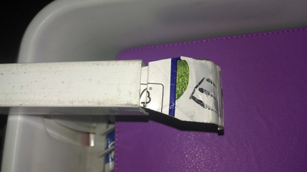

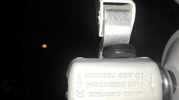

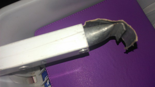

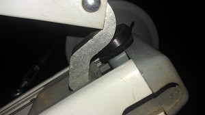

We have been through a few 90 kmh storms with awning/full walls and awning out only with 3 x double sprung loaded ropes with either 250mm Batten Screws as pegs or 500mm Sand Pegs and 3 x Roof / 2 x Aussie Traveller Anti -Flap Rafters without a drama over the last 14 yrs of Fulltime Travel. We are usually the only ones with an Awning left out in these circumstances most times except maybe when at Greens with Dougwe in residence. I have learnt an extra Tip from an Older Grey Nomad which also makes it less of a Problem with high winds. This is fitting a Small Rubber Stop under the end of the Top Locking arm near the Roller shaft before tightening the Locking Nob. Another I have devised which is to Stop the rubbing Noise of the Rafters where they fit into the Locating Brackets on the van ie a small triangular piece of UHT Milk Carton slid into the end of the Rafter and together with the end is slid into the Bracket and Acts as a Wear Plate.
