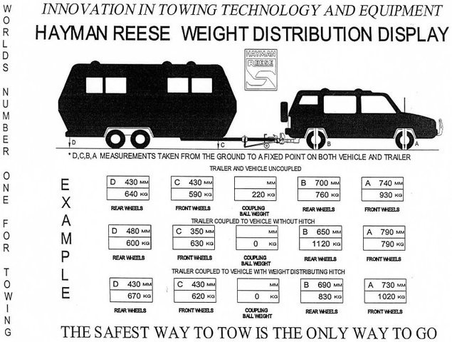

This business of "making your rig look level" is only part of the solution. Then you hitch a van the rear of the tug takes a nose dive because of the weight placed on the rear axle. With the vehicles we use with vans there is a large overhang of the ball from the rear axle. This rear overhang amounts to around 50% of the wheelbase (with the Disco D11 it is 60%.) That means that the lever action of this large overhang will remove weight from the front axle, if your overhang is 50% the weight removed is 50% of the vans ball weight. Where does this weight go? It is transferred to the rear axle.
The result of this is the front of the tug rises because of the weight removed. The rear axle is severely overloaded as you have around 150% of the ball weight on it. This see-saws the tug severely and it looks crook and does not handle well because wrong load distribution. It is much the same as putting too much gravel in the rear of a ute and expecting it to handle OK.
Jacking up the rear of the vehicle with modified suspension does nothing for the weight distribution. It just makes it look "pretty." The only way you can correct the excessive transfer of weight is to use a weight distribution hitch. This transfers some of the ball weight to the front axle thus restoring its handling and reduces any tendency to of overloading the rear axle.
The following demonstration of WDH shows the action. Get out your pencil and paper and calculate the changes.

When you hitch a van to an overhung ball (well behind the rear axle), it adds weight to the rear axle and REMOVES weight from the front (steering) axle.
This can compromise both steering and braking.
The WDH transfers some of the weight from the rear axle back to the front axle to partially correct that problem.
Air bags CAN NOT do that. They simply jack the back up. Airbags and WDH do quite separate things.

I have a Ranger and a van with 280kg ball weight. When I fit the WDH on level ground and pull the bars up to the sixth link in the chains ( Hayman Reece say that's the maximum you should use) the bars don't apply much force to the front wheels and they are very easy to pull up and to insert the pins. Without the WDH the vehicle and van sit level. With them attached it reduces the distance from the top of the front wheels to the wheel arch by 10mm. I have towed the van with and without the WDH and honestly I can't tell the difference in terms of steering and baking. Is this the experience of other Ranger and BT50 owners?
