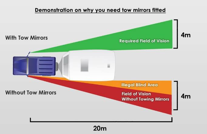

Banditandjo Hi,
Simply You must be able to see both rear corners of the van from Your normal driving position. No You do not need to see behind the van. No You cannot travel any distance without being able to see both rear corners and the mirrors must not protrude more than 150mm beyond the vehicle width. When the van is attached the the vehicle width is taken as the van's, disconnect the van & You then need to remove the towing mirrors.

I note that you have asked about the "legalities" concerning mirrors. I have pasted the below reference to the law as it relates to this issue in Queensland. I know that there is equivalent legislation in other States / Territories.
Transport Operations Road Use Management (Vehicle Standard and Safety Regulations 1999) (Schedule 1, Sect. 25)
"24 Rear vision mirrors (1) A rear vision mirror or mirrors must be fitted to a motor vehicle as required by this section so that a driver of the vehicle can clearly see by reflection the road behind the vehicle and any following or overtaking vehicle. (2) At least 1 rear vision mirror must be fitted to (a) a car; and (b) a motortrike with 2 front wheels; and (c) a motorbike, or motortrike with 1 front wheel, built before July 1975. (3) At least 1 rear vision mirror must be fitted to each side of (a) a motor vehicle with a GVM over 3.5t; and (b) a motorbike, or motortrike with 1 front wheel, built after June 1975. (4) A motor vehicle with a GVM not over 3.5t, other than a motor vehicle mentioned in subsection (2) or (3), must be fitted with (a) at least 1 rear vision mirror on the right side of the vehicle; and (b) at least 1 rear vision mirror on the left side of the vehicle or inside the vehicle. (5) A rear vision mirror fitted to a motor vehicle with a GVM over 3.5t must not project over 150mm beyond the widest part, excluding lights, signalling devices and reflectors, of the vehicle or combination. (6) However, the rear vision mirror may project not over 230mm beyond the widest part of the vehicle or combination if it can fold to project not over 150mm beyond the widest part."
If you read the above very carefully, you will also note that it specifically requires a "REFLECTED VIEW". (These are not my words BUT the words in the legislation).
The key to reading and understanding the above concerns the fact that the mirrors must be able to provide the view specified. If they can't, then aux. mirrors are obviously the only way that one can restore the view that is legally required.
Personally, I use both towing mirrors and a Rear view camera to supplement the view afforded by the towing mirrors. Trucks are commonly seen with signs on the rear of their vehicles which read "If you can't see my mirrors, I can't see you".
Food for thought!
Hope this is of some assistance.

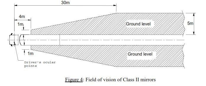

banditandjo wrote: our mirrors can see beside van with no issues but not behind van.
The requirements for mirrors is governed by ADR -14. There is a good diagram showing the requirement in that document.
Before the subject of cameras is raised, ADR-14 allows them to be used in lieu of mirrors but two cameras must be used and cover the same field of view shown in the above diagram.

hako said
09:48 PM Feb 6, 2016
PeterD's "Field of vision of class II mirrors" indicates to me the driver is sitting in the front passengers seat?? KFT's link refers to traffic fines imposed for offences??
I'm with chooknphil inasmuch as I really don't know what the road rules require.
Please don't think I'm nitpicking, I know the intentions are good but if they leave one confused.....
So what's the problem? The Oz standard incorporates the European standard, they sit on the LHS in Europe. I thought members would have been able to figure this out without me explaining that you have to mirror reverse the European standards to fit out toads. You are going to find more of this as we adopt more and more overseas standards in the interest of freer international trade. We have been doing this amongst Australian states, the responsibility of developing road traffic standards has been shared amongst states instead of each state developing a full suite of standards of their own.

hako said
11:25 PM Feb 10, 2016
PeterD wrote:
The problem Peter is that your post inferred that the illustration you included was part of ADR-14. You said:
"The requirements for mirrors is governed by ADR -14. There is a good diagram showing the requirement in that document."
My query was simply why is the driver sitting in the passengers seat....that is the problem.
I hope road safety never requires us to mirror read the regulations.
I do appreciate all the trouble you go to when providing assistance and help to people like me on this forum - sometimes when things appear wrong or unclear in a post if we do not query them we end up ill-informed.

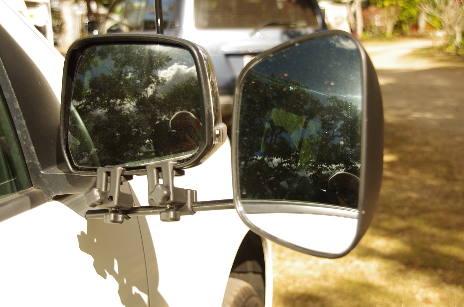

G'day Bandit and Jo
I find a good test is to get the rig straight and look along the side of the van towards your car. If you cannot see most of your mirror then you are going to need towing mirrors to be legal.
I have used several different types over the years but the ones I have now are the best I have ever used.
The Milenco grand aero are easy to put on and off, stay correctly aligned between uses and have not blown back in 30,000 km of travel.
These mirrors are available from caravans plus in either flat or slightly convex.
This is what they look like on my Navara
Frank

Having a Pajero and having the ongoing problem of mirrors folding on drivers side when a truck blasts air when passing is a pain.The Pajero mirrors fold and do this very easily, too easily. I have used the ORA mirrors with the suction cap arms. I have noted two things:
1. I do not need the suction cap on the passenger side mirror, it is does little and if fitted unsticks with change in temp and humidity and pulls the mirror out of alignment. I just use the ORA mirror attached to mirror with no bracing arm and it works fine.
2. The suction cap arm is worse than useless as it comes unstuck and you have to stop to re-stick, unfortunately the ORA mirror on its own still gets knocked back by trucks air blast so the solution is, I have left the the suction cap arms at home and bought one arm with magnetic pad for drivers side mirror. This works really well and I wish I had gone this way in the first place.

For Clip ons the Milenco Grand Aero are very good & relatively inexpensive as well as being transferrable.
I migrated from my modified 10 year old Ora mirrors to Milenco. They are much better. Very little vibration & a large clear image. I would have liked a longer arm but it is perhaps the maximum legal size. The one I made f or the old mirrors was much longer. But the drivers side Milenco still suffered from foldback. Easily fixed by a flexible strap to a radio aerial bracket.

Hi all. Can someone point me in the direction of where to find the law on seeing the back corners of the caravan for legal use please. Chooknphil
Thanks for the info KFT.
you should have a good look at PeterD post above
Rod
Hi KFT. I did look at ADR 14. But could not see anything that referred to the back corners of something being towed With grad to mirrors. May have missed it , if someone has the info would be greatly appreciated. Chooknphil
This is the road rule that applies and the diagram that PeterD posted shows you what view the rear vision mirrors MUST have.
http://www5.austlii.edu.au/au/legis/vic/consol_reg/rsrr2009208/s297.html
the link above refers to road rule 297 and if you look it up on your state road rules site you should find it. I linked to the federal legislation
-- Edited by KFT on Saturday 6th of February 2016 07:27:06 PM
-- Edited by KFT on Saturday 6th of February 2016 09:54:37 PM
Hako this diagram may be of more benefit
" The requirements for mirrors is governed by ADR -14. There is a good diagram showing the requirement in that document."
