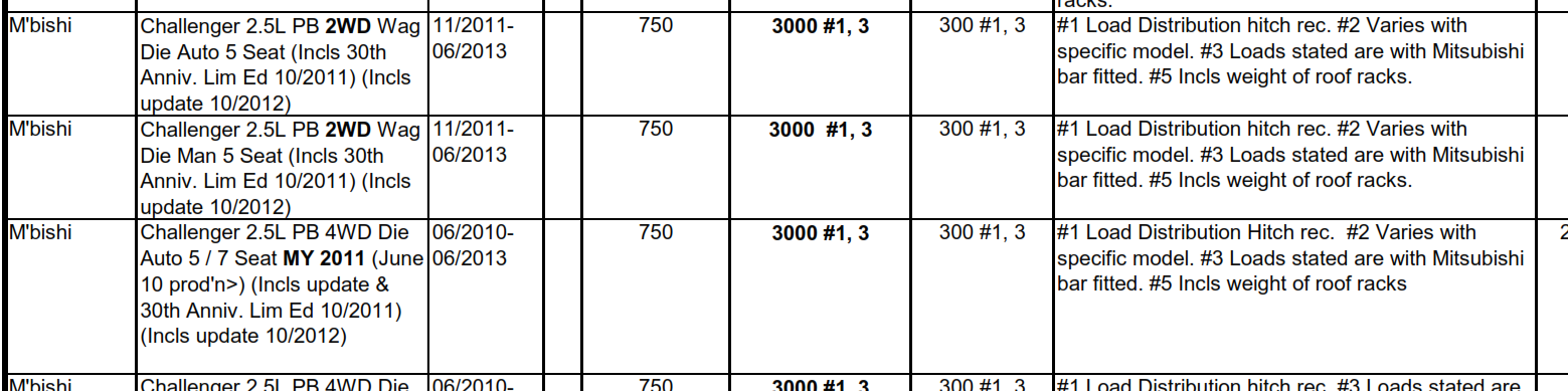

Wrong information. The following comes from a listing produced by RACQ and the Caravan Trade & industries Association. The listing is information from the vehicle companies. Take the manufacturers advice and use a WDH (Load distribution hitch.) Don't take forum members advice to use band-aid fixes like modifying suspension instead of WDH.
What you need to be aware of is the CVM "Combined vehicle mass", ....................
It is actually called the GCM, "Gross Combination Mass" which is the maximum allowable mass of the tug and van combined, when fully loaded.

None of the chassis bends have occurred when WDH is used. All the broken chassis have occurred by overloading and mainly when air bags were fitted. WDH will counter large ball weights bending chassis, it stresses the chassis in the opposite direction. Please show me a case of chassis being bent by WDH, in the mean time please get your facts straight.
