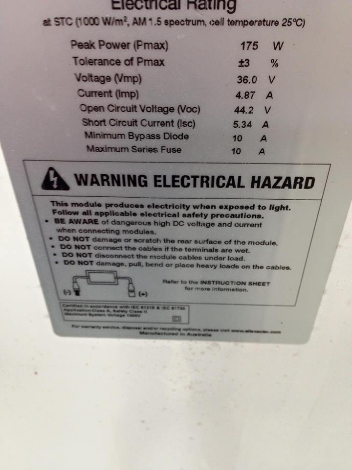

have the chance to purchase a 175 watt solar panel with no controller for $100 it appears to be ex domestic roof panel. are these suitable for use on car/van batteries .
It is usable but you need an MPPT (Maximum power point tracking) controller. The PWM controllers for 12 V bateries need panels with a Vmp of around 17 V, yours has a Vmp of 36 V.

Although your panel has a Voltage (VMP) of 36 volts, it also has an Open Circuit Voltage (VOC) of 44.2 volts, which your panel could achieve at a worst case scenario.
I would therefore advise that any solar controller you obtain, is capable of regulating your highest voltage of 44.2 volt panel down to your battery voltage.

Tony, the D250S is the only MPPT regulator that has such a low maximum input voltage. There have been reports from others asking what when wrong when their D250S was zapped when they used a higher voltage panel (they did not read the specifications and/or understand them.) All the other MPPT controllers will handle higher voltage arrays, it's just a matter of reading the specifications seeing what is the maximum open circuit array they will handle.
