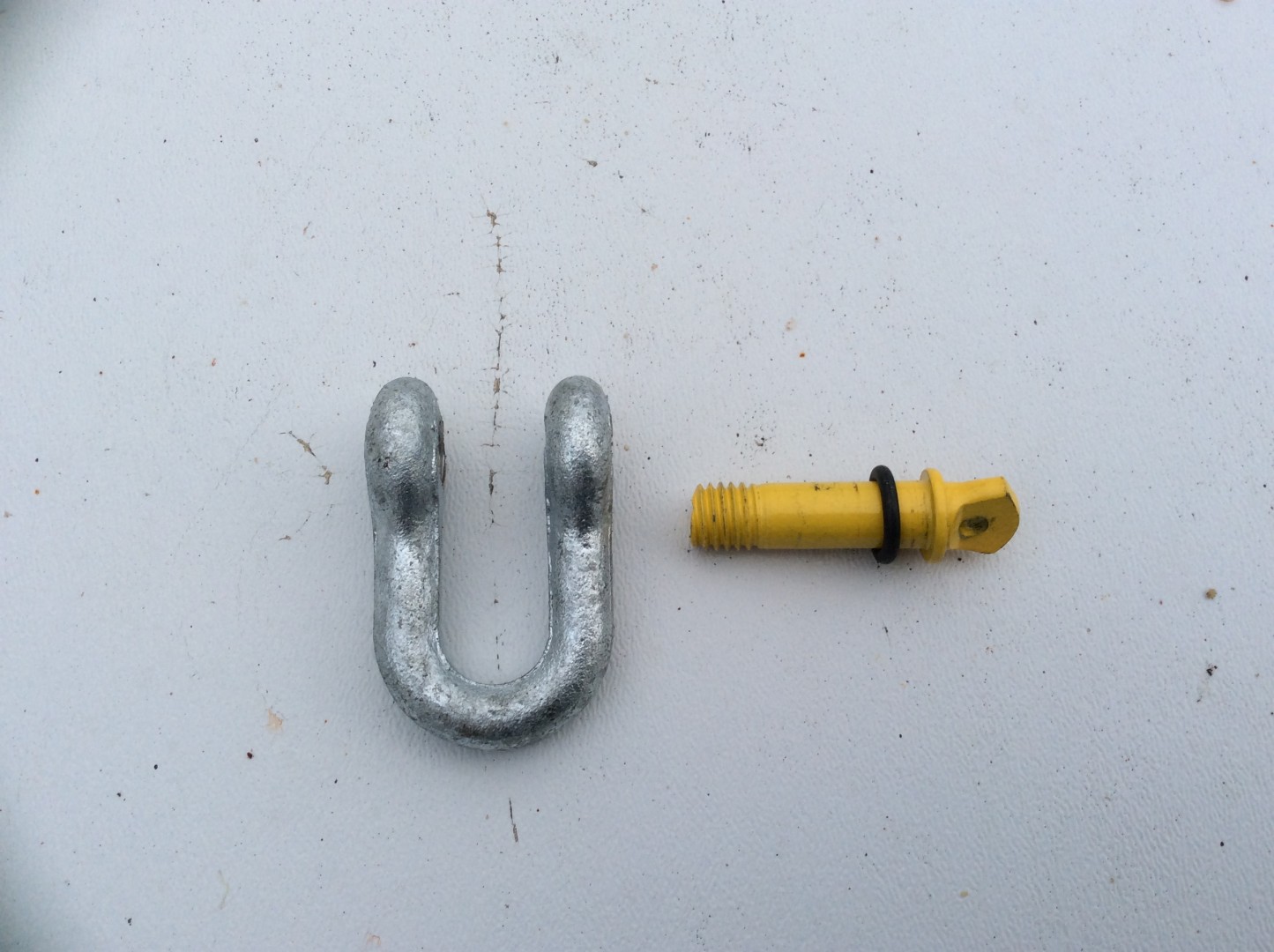

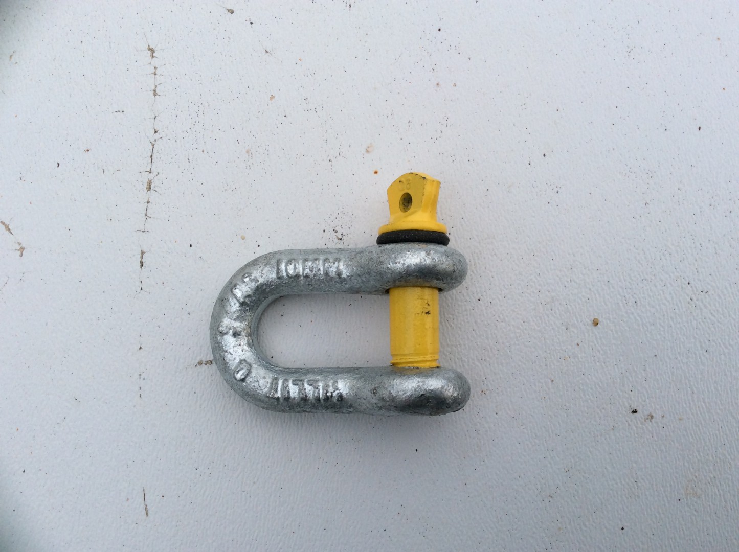

This could be a handy hint for the very tight d shackle pin, just put a rubber o ring on the D shackle pin and it won't bind up tight, undoes with ease.
A good idea Olley UNTIL the O ring breaks (when you least expect it) due to age/exposure to sunlight.
Then you could have trouble, seen plenty on boats come undone over the years.
I ALWAYS tighten mine with pliers when connected.

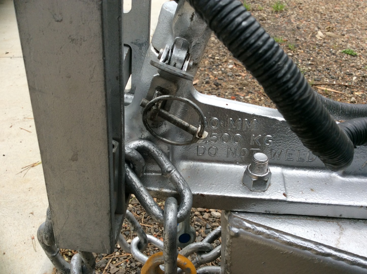

I use a similar idea for the coupling ,a tractor lynch pin.
Lance C
