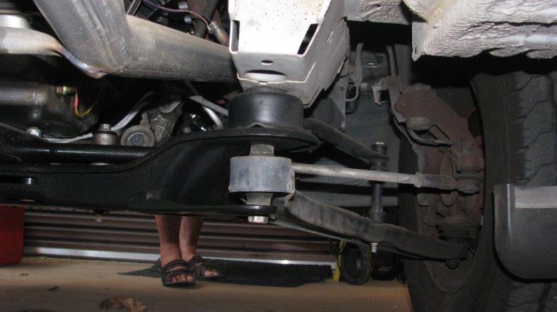

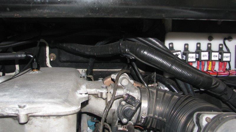

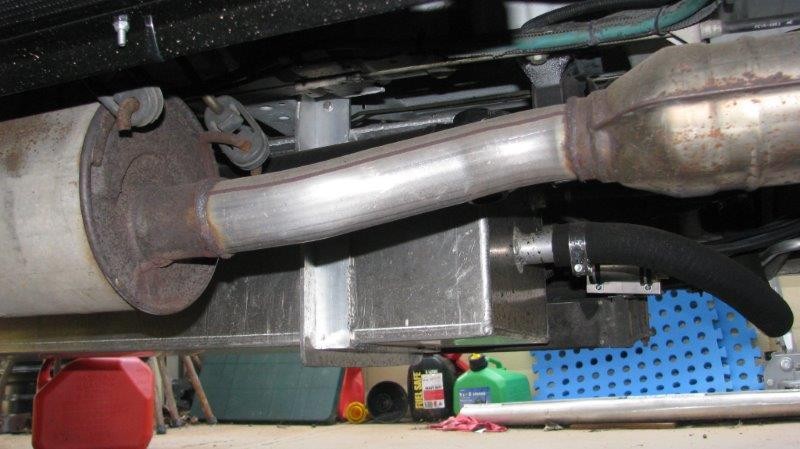

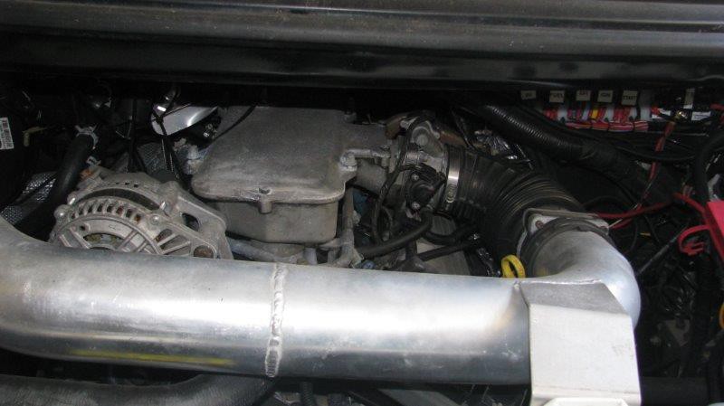

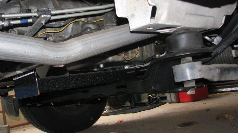

I was at my brothers today and took a couple of photos of his conversion.
You can see the new gearbox mount, new exhaust and the new repositioned fuel tank.
The photo of the engine shows how little room there is to work. My brother said if he was doing it again it would be easy as we know all the problems now.
We would also do it when we had less years of wear and tear. It does have heaps of power. Hope these are of some help.

Hi Terry
