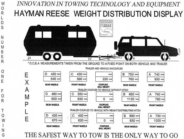

1.. Suspension upgrades are only for those who overload their tugs. They do not attend to the weight transfer of weight from the front wheels to the rear wheels when you hitch the van. This diagram shows the weight transfer effect when the van is hitched and the then when the WDH is hooked up.

Here we go ..
When you put weight on your tow ball (ball weight) it acts like a load on a lever with the fulcrum point being the rear suspension (springs or air bags). The result is that the front of the vehicle is levered up, taking steerage/breaking weight off the front wheels.
I can't see how strengthening the fulcrum (ie. stronger springs or airbags) solves this problem to any significant degree.
I await with great anticipation for all of the forum 'experts' to enlighten me.
Perhaps a quick read of the attached document might be of assistance ..
