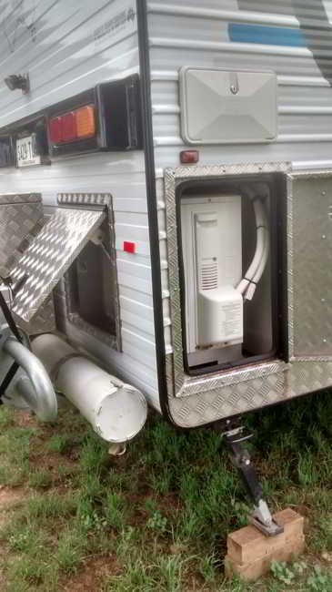

D and D said
05:35 PM Feb 3, 2016
adventure before dementia wrote:
Ty so far for all your responses, look like a split domestic system will be the way to go . D and D, Banjo where is your outdoor unit mounted and how big are the units your both got . I guessing l am concerned about vibrations, loose connections over time and gas escaping out . Ty
The inverter unit is located at the rear of the van (see pic) which was possible because it was always going to be there so the van was constructed with that in mind. The header unit is located above the bed at the front of the van. I've seen the inverter's mounted on the rear bumber although I'd think twice about that because of the weight and I'd make sure it didn't affect the van's balance. The header can really go anywhere provided you can get the pipework to and from it.
Capacity is: Cool - input 0.65 kW, Output 2.65 kW; Heat - Input 0.75 kW, Output 2.90 kW., That's what it says on the sticker and I have no idea what that means. If I was getting it done again I'd probably go for a slightly larger capacity.
Dave
