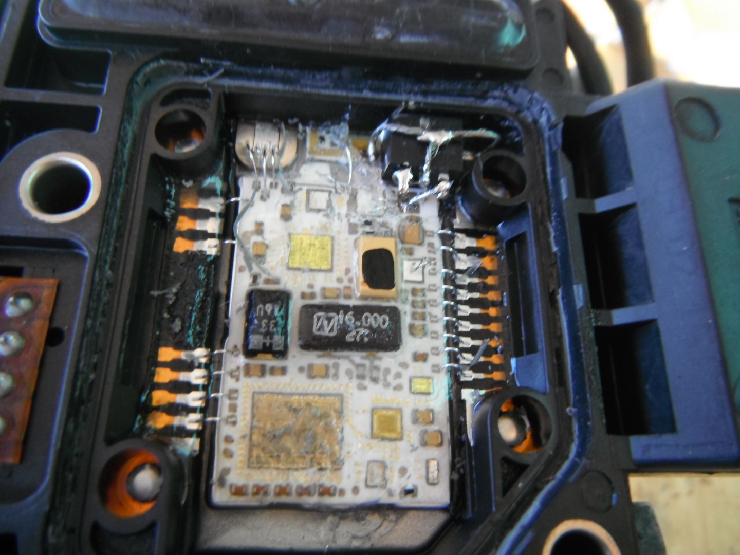

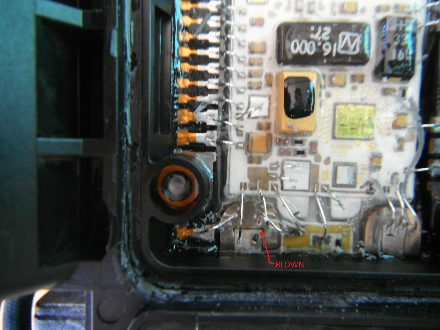

If its one of these pumps? Yes it will just stop & not re start. These have a small computer in them & the driver for the spool solenoid fails. If it has they are repairable.
This is one ive repaired & is still going 4 yrs later. This pump was of a Rodeo diesel.
