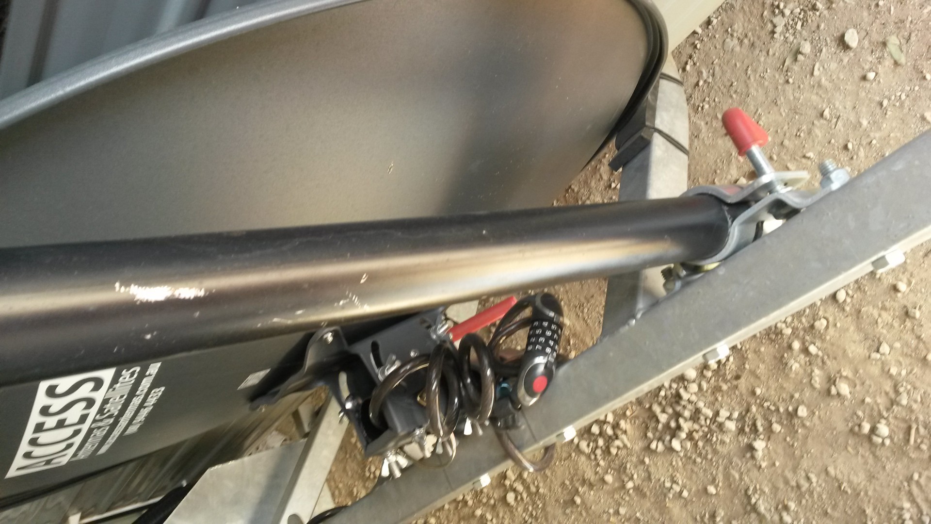

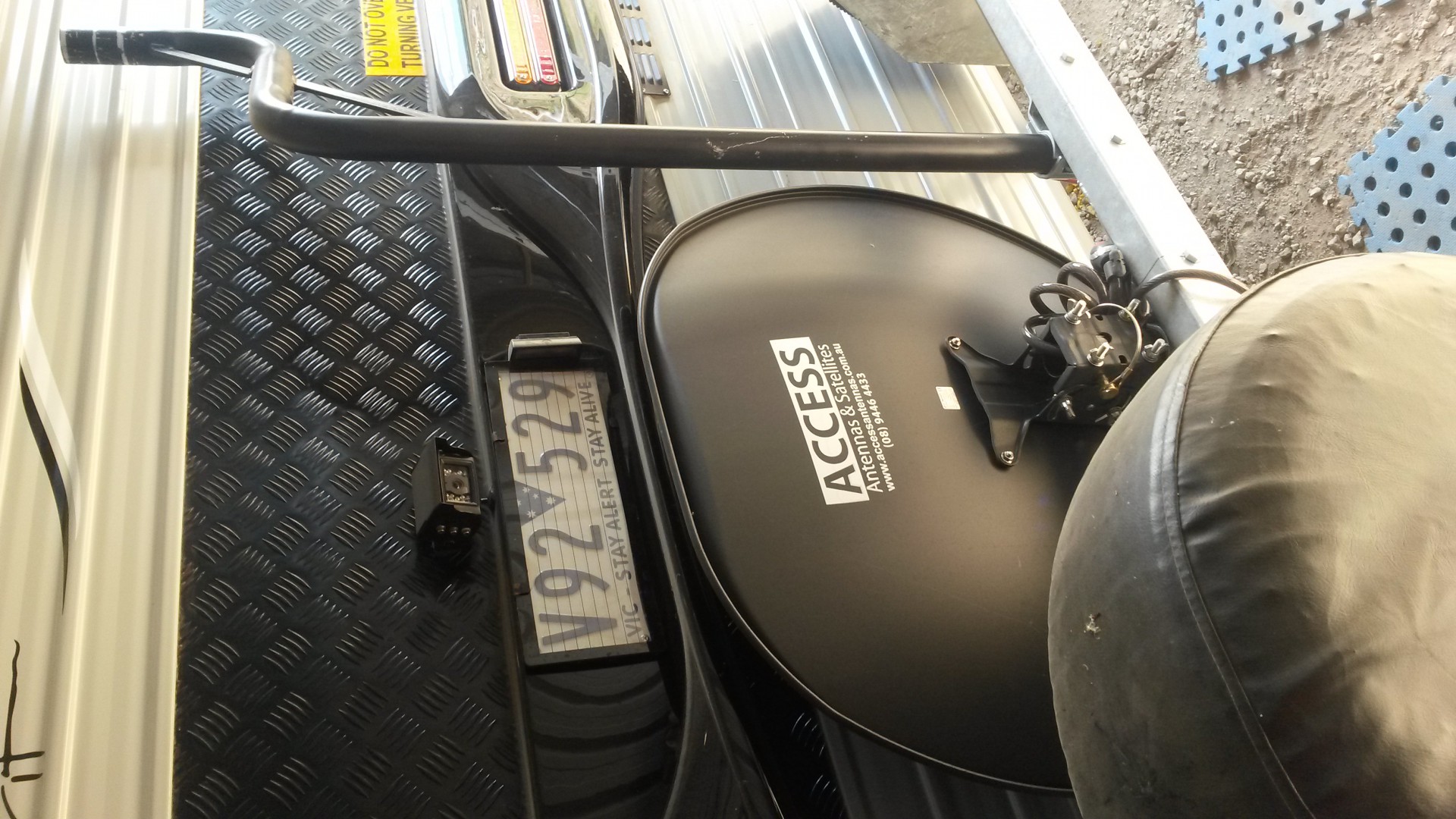

I purchased this "bent pipe" when I bought my kit to save on postage.
I then went to a car exhaust pipe company and got them to make me a couple of lengths of exhaust pipe which they flared to fit the "bent pipe". I then bolted the pieces of exhaust to the caravan. One pipe on the front and one on the back, the "bent pipe" then just sleeves into the flared end of the exhaust pipe and is secured by a long bolt inserted through a couple of holes I drilled.
Therefore, I have a mounting point for the antenna dish on both the front and back of caravan which gives me 360 degree coverage. The tripod is stored in a locker and only used if I cannot get good reception from either the front or back mount due to trees or other obstructions. I store the dish under the bed, as I am not comfortable with travelling with the dish permanently mounted, though many people do travel with their dish mounted on their A frame or rear caravan bumper.
PS the "bent pipe" comes with a jockey wheel clamp for mounting the pipe, but I preferred to not use it and used the exhaust pipe mounts instead.

www.accessantennas.com.au/perth-discount/satellite-kits-systems/caravan-satellite-kits2/s-bend-pole-with-draw-bar-mount-to-suit-satellite-dish/
