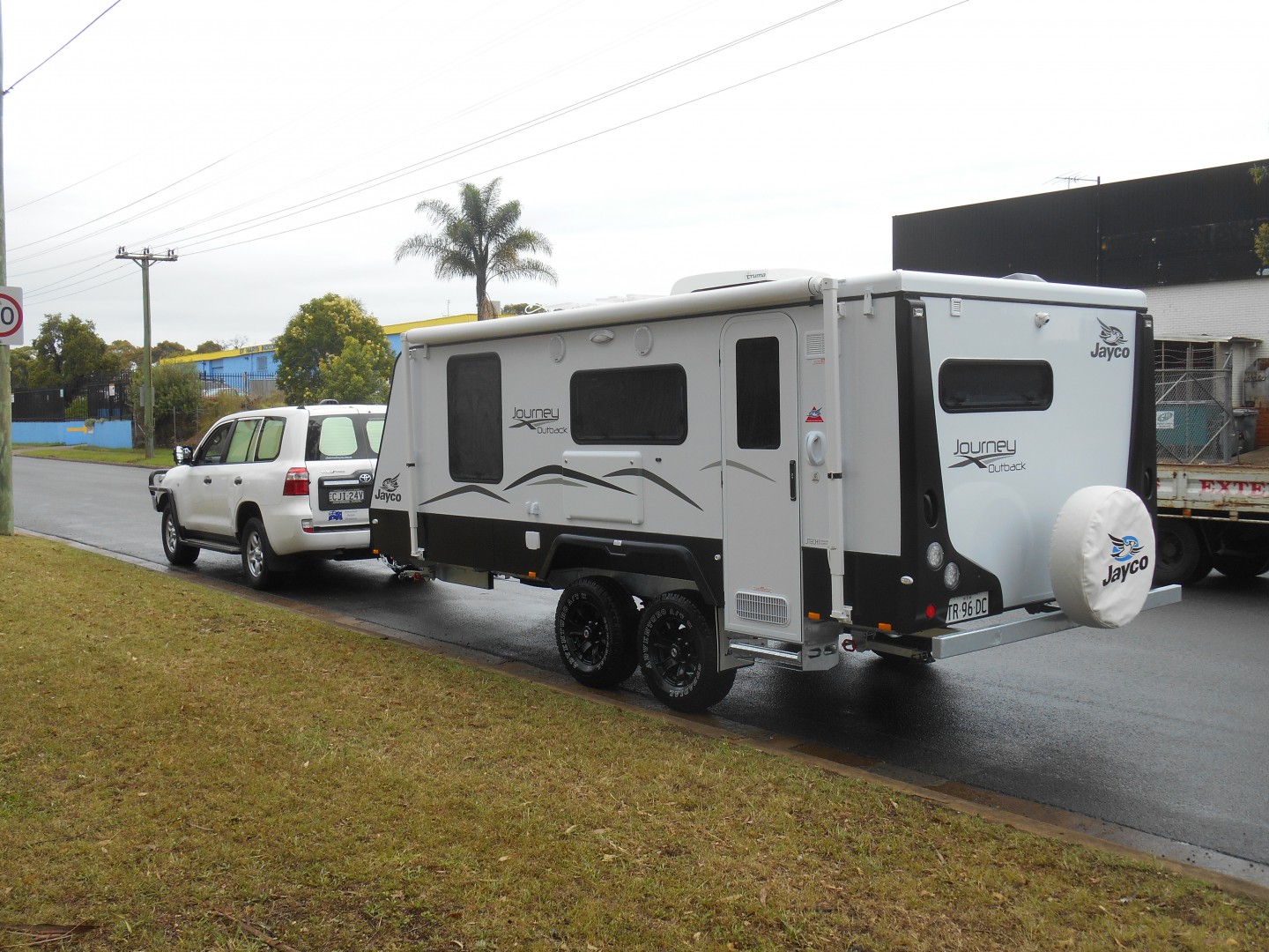

We to have JJO 17.55-3 If you are handy I would buy and install yourself. We are buying off Flea Bay before hitting the road. I'm in the process of correcting all the wrongs on ours. I would allow $600 for labour from them.

Thanks jim for you answer. Your van looks like ours and it scares the hell out of me. I will do some of the driving and the van looks so big. We have a hard floor camper trailer at the moment. Will get our van near the end of april
