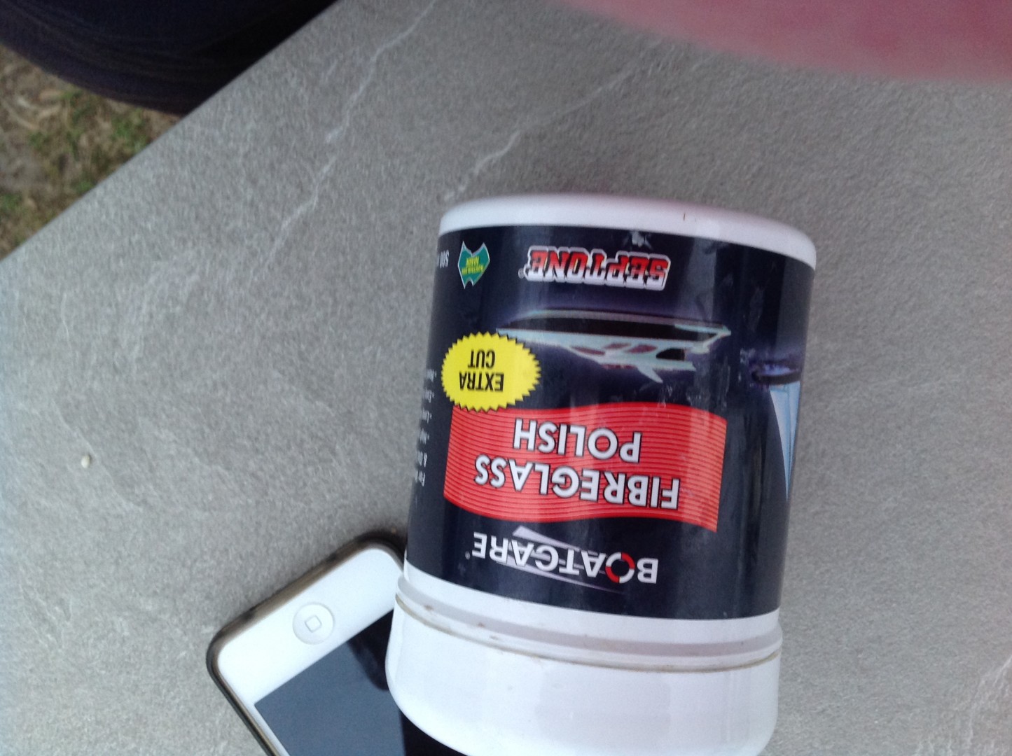

My Brother uses this on his 10 year old Golf and swears by it.
Can't think of the name of it but its in a blue & white screw top plastic container from BCF. It's a restoration polish for fibreglass boats that's designed to bring up a dull surface. I used it on "Roadworx" 18 months ago because the body was very dull and it came up a treat. Since then, I've just used a simple wash & wax detergent from Repco and I'll do another buff up with the BCF product (of which I've still got half a container left) before our next migration north in a few months.

Thanks to the three replies, just back from BCF with polish.
