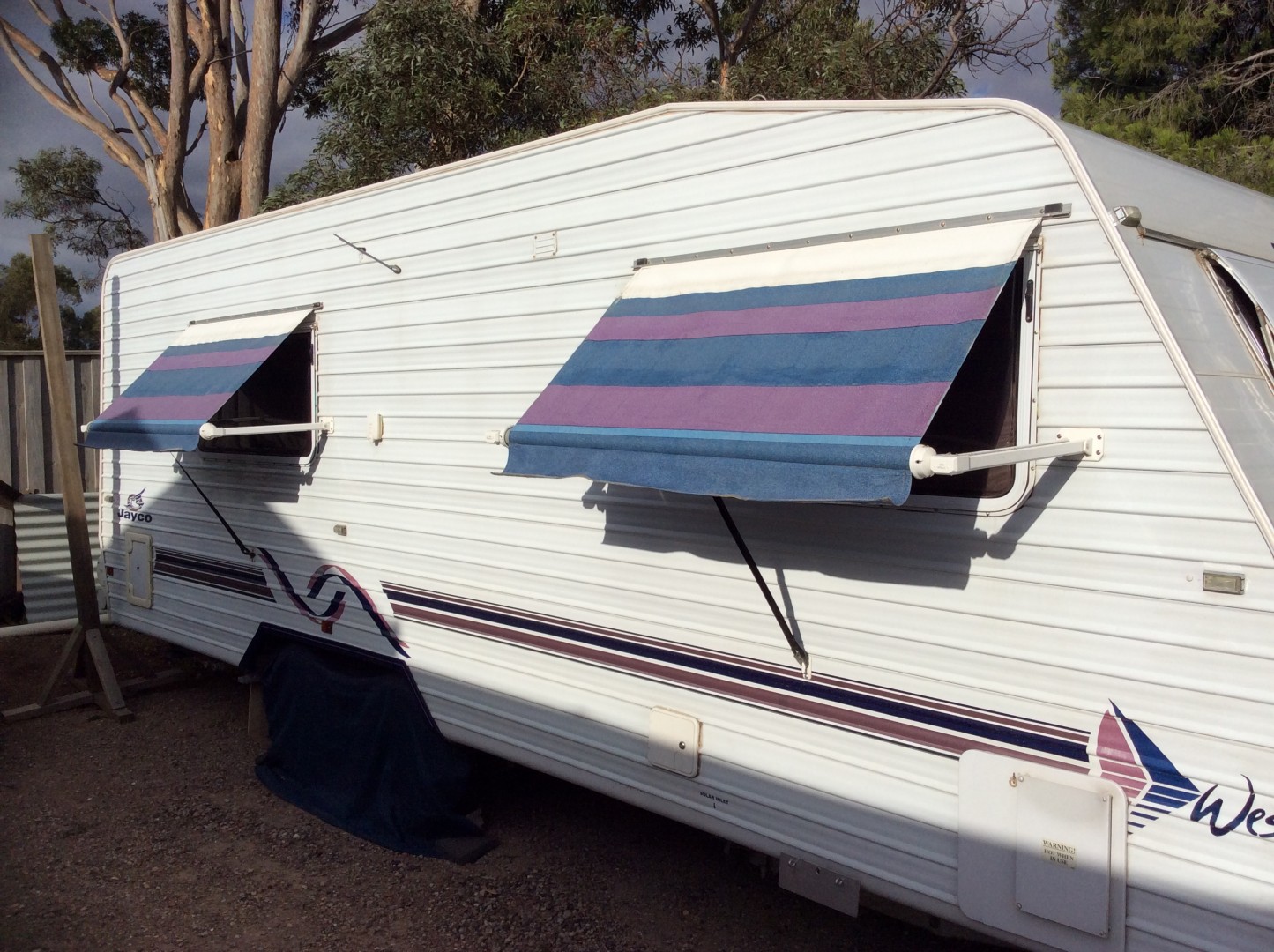

Try a couple of these on your Windows Jim if you have them on the other side,you can leave them open all night, unless the rain is coming from an angle,it will soon wake you if it is.
If it is you can roll it all the way out, then pull out the stays, then roll it back until the stays are at their shortest. Still need ropes, but will give you shelter for your door and windows with very little flapping or noise.

Olley46 said
08:40 PM Jan 24, 2016
Hi Glen They were on the van when we bought it s/hand ,the brand of the awnings is the same as the big one carefree Colorado, they are so handy when have the sun coming from that side, a great little invention.
Lance C
Lance C
Lance C
