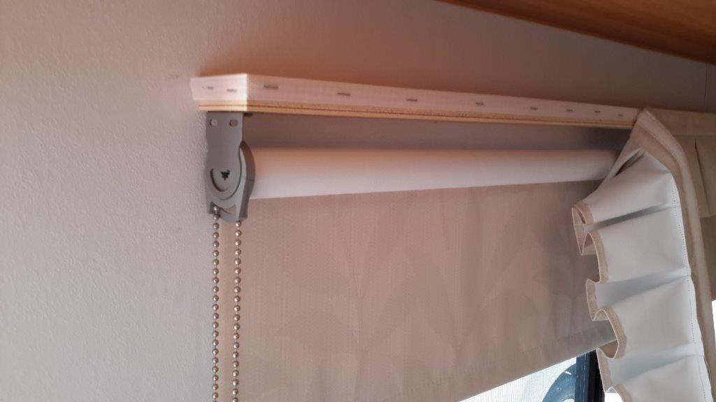

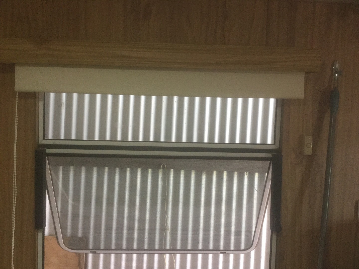

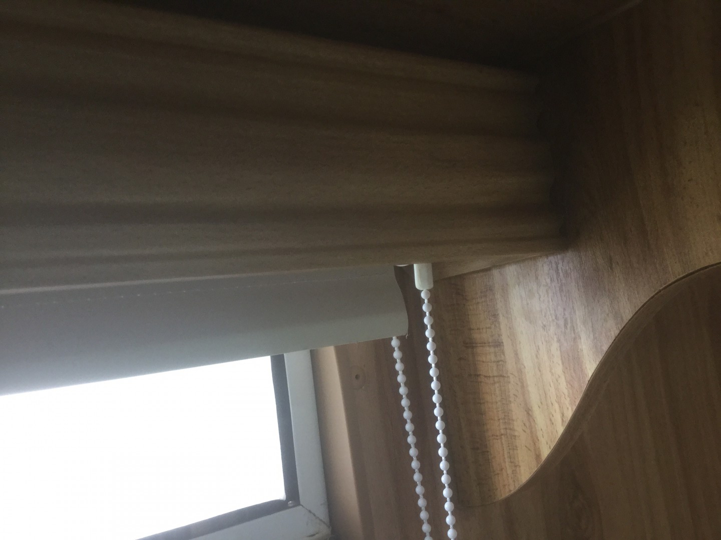

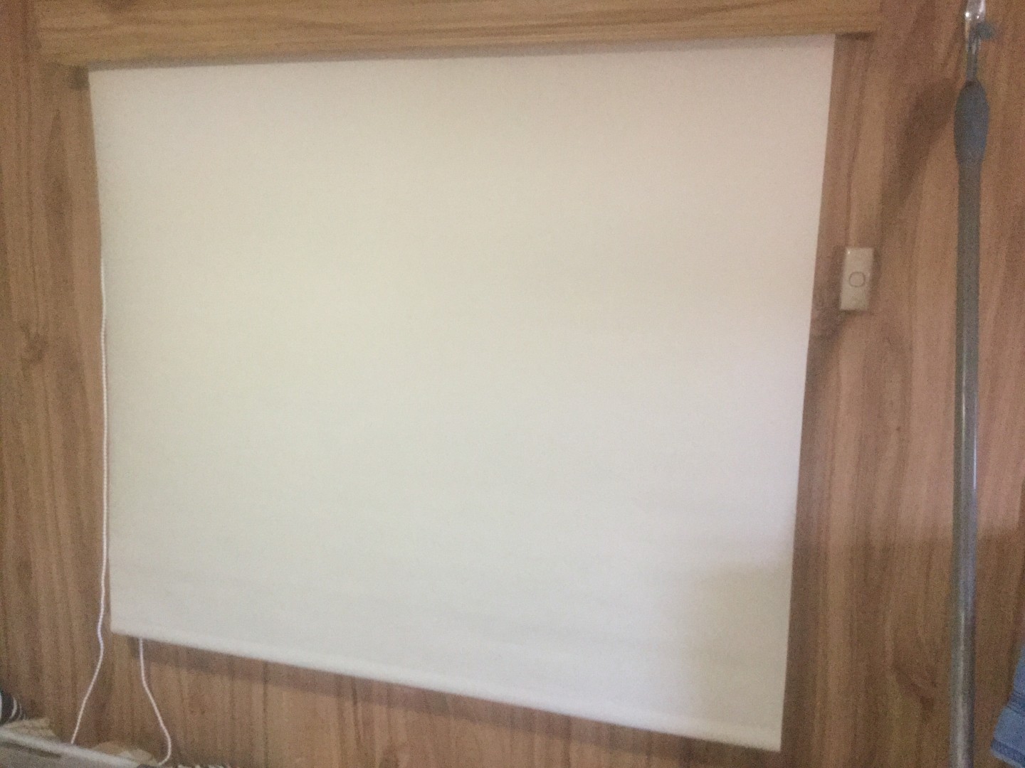

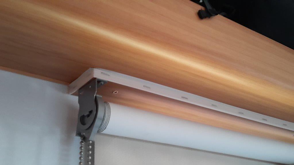

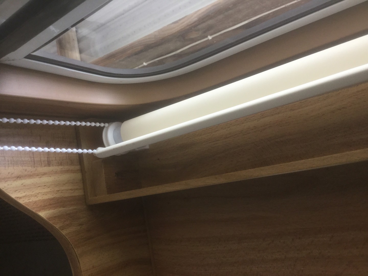

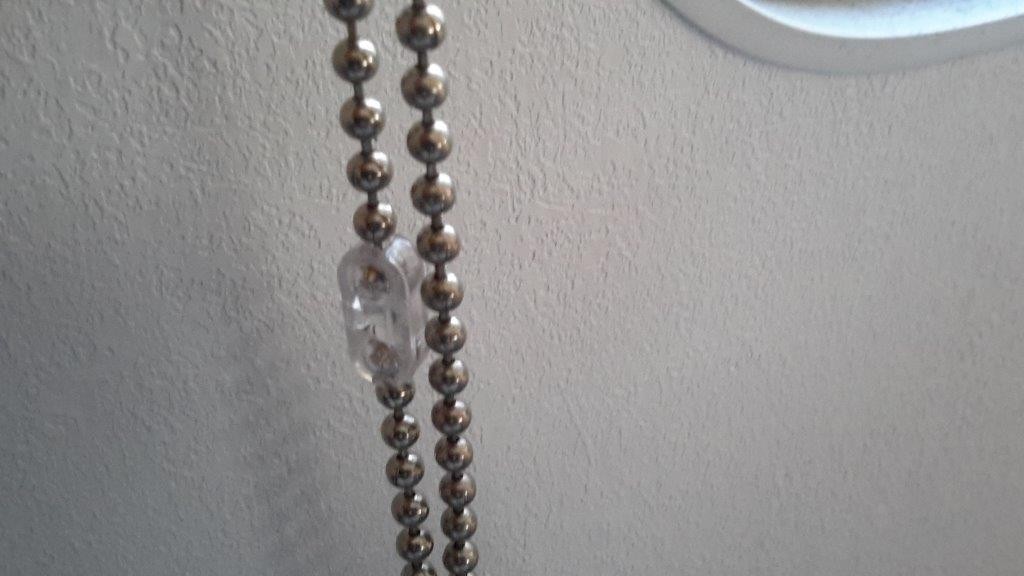

Our windows are a mix of windout and sliding. There were already pelmets for the curtains so I was lucky enough just to use them, however the pictures show how you could do it by attaching a timber top. I have showed both set ups. The brackets go downwards not outwards this keeps the blind close to the window and under the pelmet taking less room. I also failed to mention in my first reply that you also need to shorten the chain. You can buy the chain joiners at spotlight also. Just make sure the joiner is at the bottom so that it does not have to go through the roller. My pelmet is just attached with Velcro. very easy to clean and staples work well. I did however purchase a venetian blind for over the sink. Got that from Coromal. To keep light out make sure you go past the window a bit to get full coverage. Spotlight have the blinds at 40% off at the moment. If you were in Cairns you could come and have a look. It really was not hard to do.

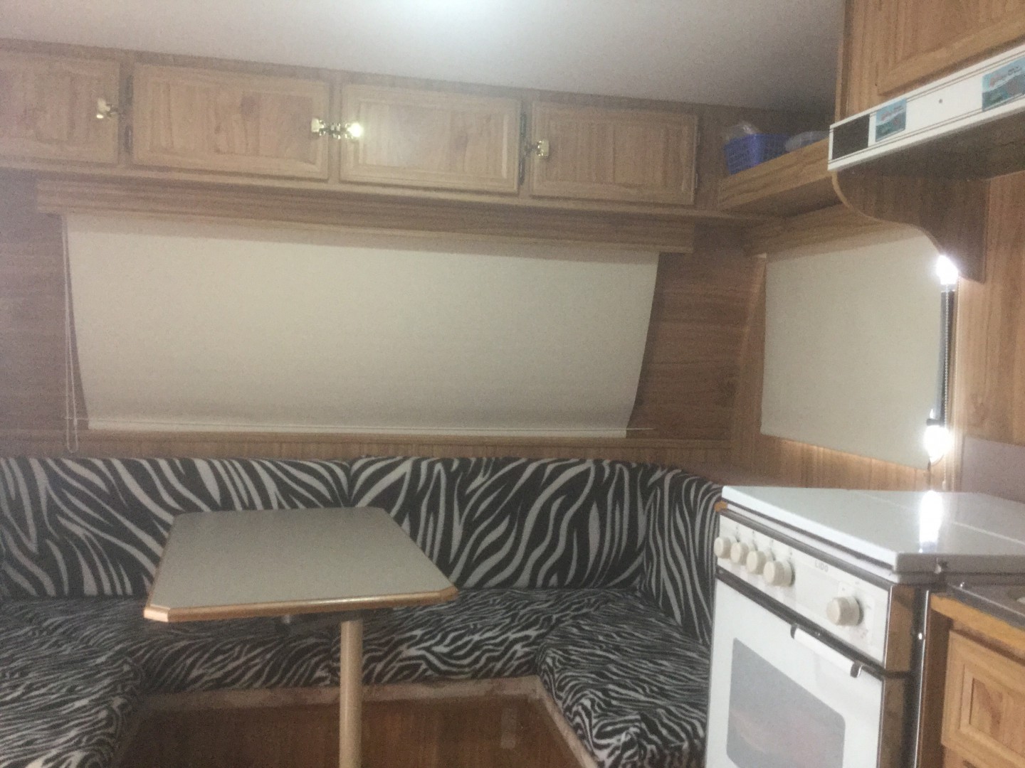

First blind done not hard just fiddley. Bought blinds at Lincraft 40% off so pleased thanks all for your replies

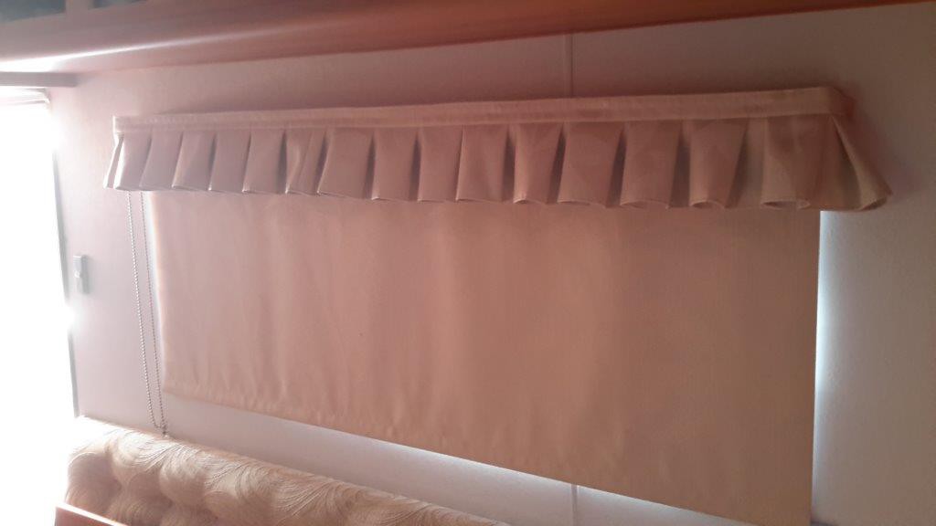

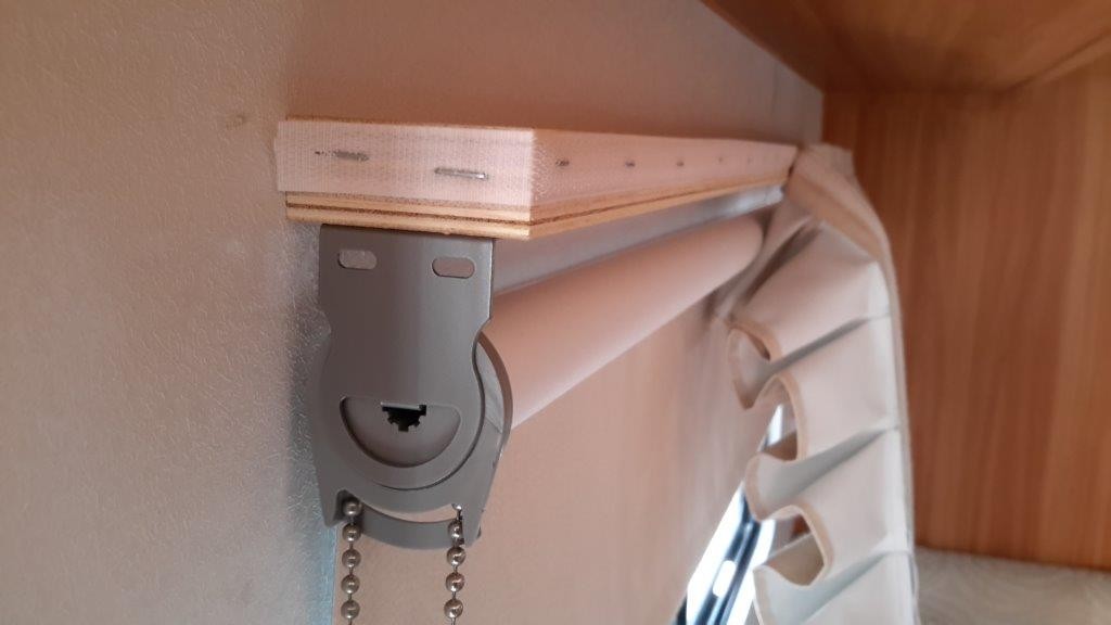

First blind done not hard just fiddley. Bought blinds at Lincraft 40% off so pleased thanks all for your replies some images of how to set blinds into pelmet if anyone wants to do them, also if any ideas for keeping the front blind in place as the angle of front of van makes blind drop straight down we have tucked it behind the curtain wire that was already there at the moment thought about Velcro but blinds would get finger marks when anchoring them all the time
