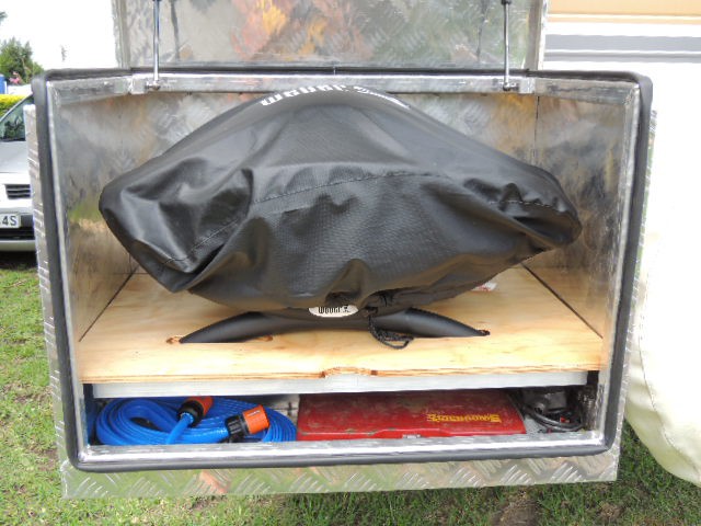

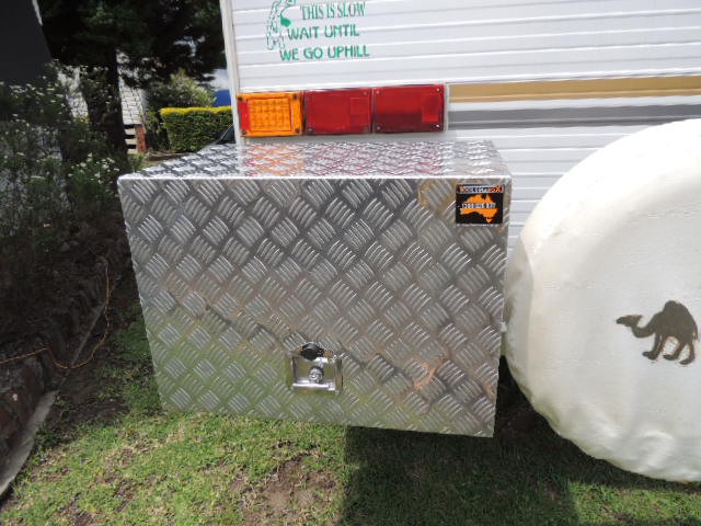

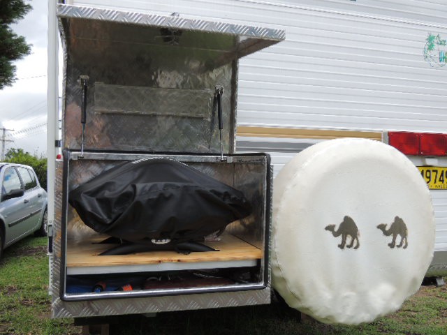

Needed somewhere to store the BBQ and under it some storage for spares and tools.
Converted a generator box to fit over the rear bar to clear the tail lights

The Webber Q cooker box looks like a good mod to conveniently store a bulky & much used item. Probably not too much weight on the bumper either.
It's mainly the size of the Webber that stops me from changing from my double butane cooker.
Vince said
04:46 PM Jan 23, 2016
Cupie wrote:
Vince ...
All up it weighs 32kg - Box - Webber - Sundry Gear
Best is it's out from inside the van and easily assessable

Vince ...
