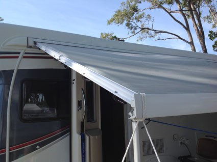

Hi Dave, So sorry to read of your awning doing a back flip. My Auto-trail also had a sissor type awning made by Thule Omnistor. During the first two trips from new it frightened me every time the wind came up. I had read stories of motorhomes in the UK having similar problems to yours. The solution for us was to fit an anti flap kit & a centre curved rafter. I purchased them from Aussie Traveller & had them fitted at their Brisbane warehouse on my way through. Additionally I use tie ropes. Those additions plus a side & end wall has worked a treat for us. I am now able to sleep at night without worrying about the awning failing. Alan's comments above are worth noting. Thus I would suggest you try to find an awning that can replace your failed unit and then fit the additions I have mentioned. The Knaus MH range is a good looking set of vehicles and you do not want to spoil it with an ugly awning. I have added a couple of images to show how ours looks. Hope this assists, Cheers, Gary C
