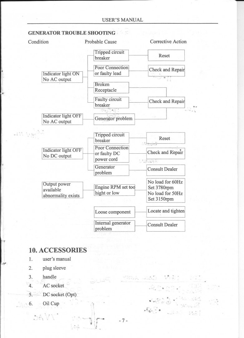

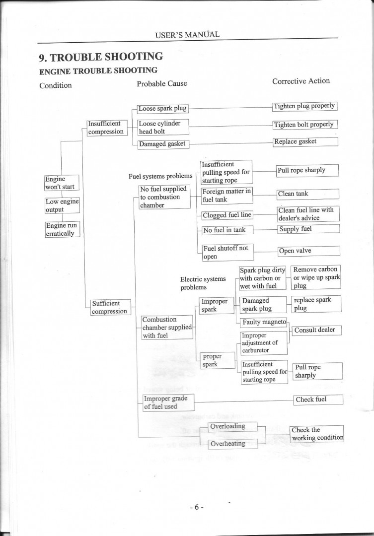

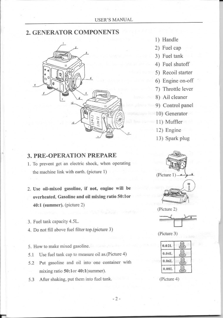

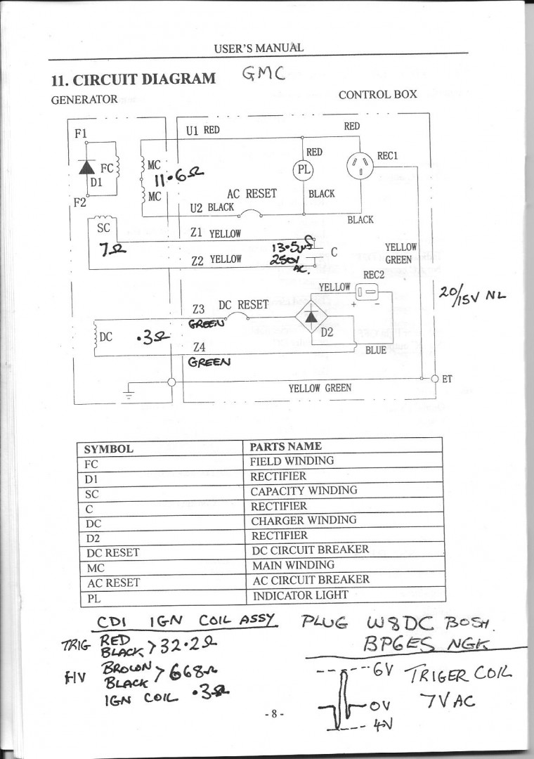

This is The owners manual they were sold under a lot of re badged names. There is more if you want them, they are parts listings & blow up of the motor & Gen if you want them.
