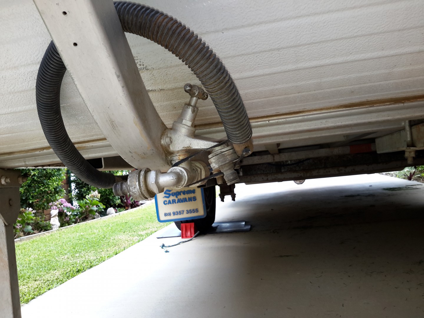

For those that fill their on van water tanks from the drain outlet, can you elaborate or link to what fittings used. Want as few connections as possible. Thanks all. Cheers.
KFT said
02:29 PM Jan 5, 2016
G'day JBell6660
All up when I did that to our van I used a barbed tee piece, a plastic inline c o c k and a barbed hose to click adapter plus a few cable ties to tidy it up. I can also use the same connection to suck water out of a bucket using the van pump(with a filter)
Frank

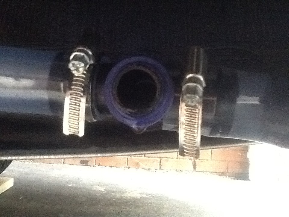

jbell6660 said
02:35 PM Jan 5, 2016
John the outlet at the bottom of the water tanks that let's you drain the tanks. Cheers.

jbell6660 said
03:38 PM Jan 5, 2016
Yes the standard Jayco problem of water returning up filler tube. A lot of people rig up a connection for fast filler via the tank outlet connection. Photo attached of 18mm thread outlet. I just wanted to know what connectors adapter etc they used. Cheers.
I have 12 mm clear plastic tube attached to water hose with male adaptor (snap connector) and I just shove it down the throat of the filler tube into tanks (approx 25mm in diameter) and turn water on full - air bypassing between the two tubes. total cost$1.50 for tube + $1.90 male adaptor. connector.

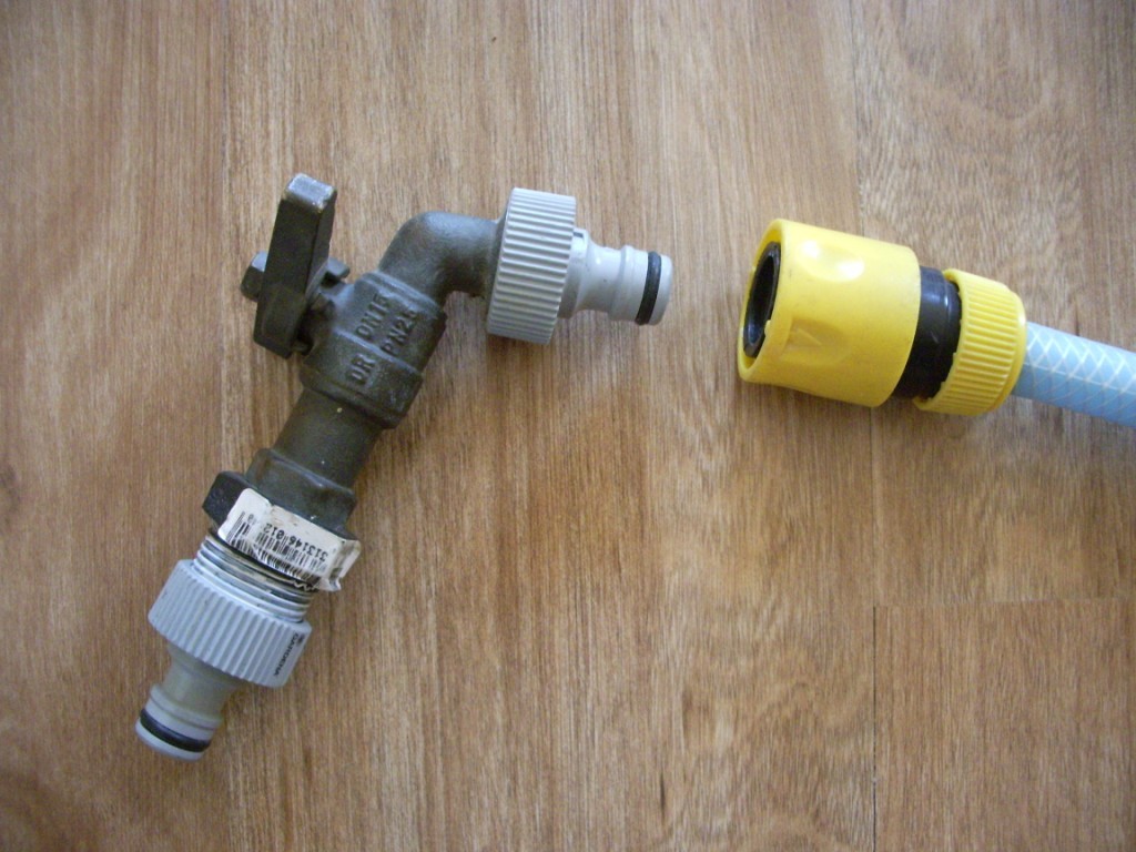

greyhoundtom said
06:31 AM Jan 6, 2016

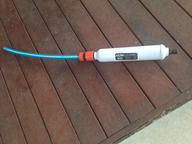

For those people with a Jayco van it is possible with a little care to screw a hose connector to the fill pipe, and then use full water pressure to fill the tanks until water comes out of the breather pipe.
-- Edited by greyhoundtom on Wednesday 6th of January 2016 06:35:31 AM
I think it's the same as Possum3 has already described. The hose is approx 600mm. The filler tubes on the van run close to horizontal before dropping to the tank. This extension allows the water to enter close to the drop to the tank, eliminating back flow.
Using this extension I can fill the water tanks faster than any previous van I've owned.
Yep Peter - Same as mine 'cept mine's prettier (clear hose and purple snap connector. LOL

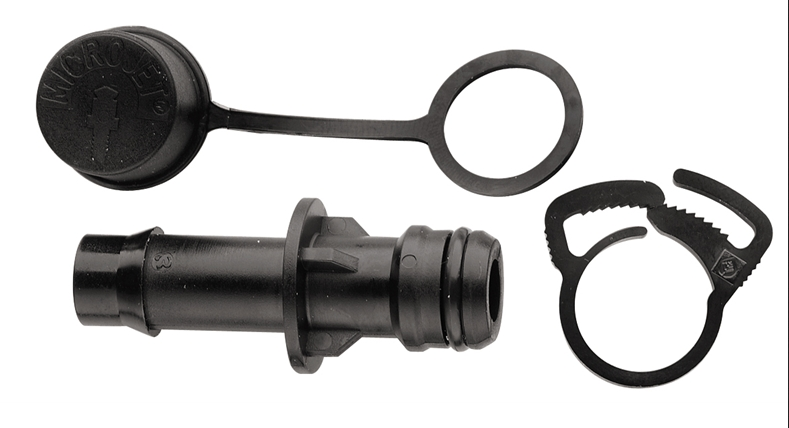

Hylife said
05:50 PM Jan 6, 2016

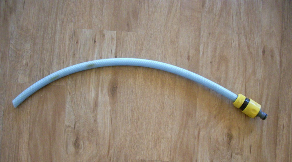

Super flexible braided hose with a click on fitting works a treat.
$10 from Bunnings
$3.80 from Bunnings
-- Edited by Hylife on Wednesday 6th of January 2016 05:52:00 PM

greyhoundtom said
08:20 AM Jan 8, 2016
Hylife, just noticed that the 12mm to 25mm fitting you posted a picture of, has two O rings instead of the usual one to seal the connector. Brilliant idea, about time too as leaking at that point in the connection is a major problem in a lot of fitting I have used.
-- Edited by greyhoundtom on Friday 8th of January 2016 08:21:17 AM

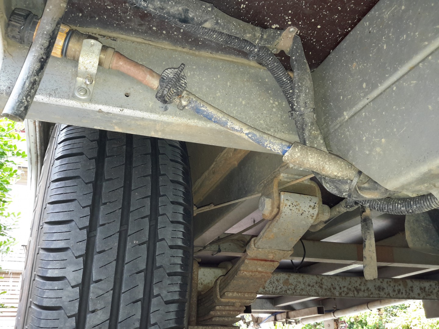

02:18 PM Jan 8, 2016
wasn_me wrote:
My solution to the problem.
Cheers Pete

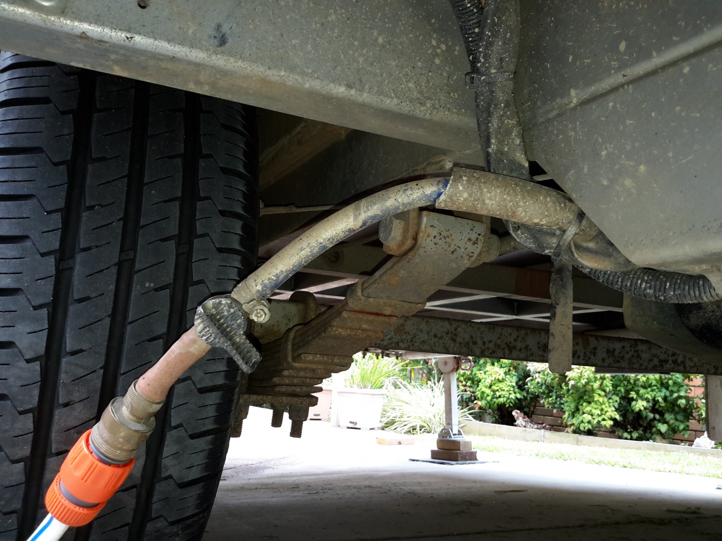

I use a similar solution. The difference is I only use one fitting on the end of the hose instead of two.

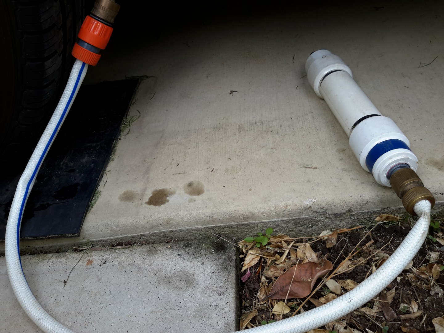

Appreciate your comment PeterD. I posted that photo to keep the reply simple.
This is the set up I actually use. When I fill the tanks at home I'm a fair distance from the supply tap. Having a tap at the van allows me to control the flow & turn the water off to change between tanks, without running back to the supply tap.
Like wasn_me, I have found the need to have a tap on the 'business' end of the filler.
Almost every time I have had to fill the tanks I am a fair distance from the tap providing the potable water, so I devised this "filler tap".
I use Hoselink fittings - but substituting 'click-on' fittings would not be a problem.
Of course this is no solution to what appears to be a problem with some vans (Jayco?) that causes the water to 'back-fill' the filler pipe not allowing the water tank to fill completely thereby requiring 'venting/breathing'.
I just thought I'd share it.

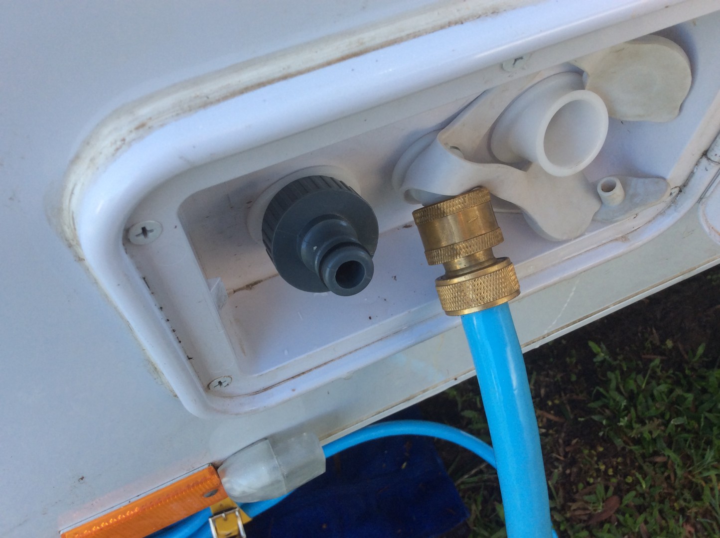

When I brought my second hand 3 year old caravan the previous owner showed me how to fill the water tank by a system he had thrown together up in Central Qld when he was away from his home base, he explained the 80 litre tank never seemed to fill hence he made this quick mood. Then I had same time up my sleeve pulled the tank out from underneath fixed the crushed breather but I thought having a method of hooking the garden hose up was cool so I tidy his job up and it also gives me a place to quickly drain some or all the water out. If say I need 8 litres to have a shower for the 2 of us, place a bucket under and let it run.
The other thing I did was while under the caravan I rerouted the hook up for onsite water to the rear as most times thats where the electrical and water points are along with the grey water.
Filling by this method takes approximately 5 going on 6 minutes for 80 litres.
Frank
$10 from Bunnings
$3.80 from Bunnings
I'd suggest you fix the problem rather than having to get under the van to fill the tank. check that there is an air outlet and that it is not kinked/squashed or air pipe has a bend down so that water could be in the pipe and stop air from escaping! Had that in my previous Jayco!
Trust that assists.
Glen
The fitting is available from Bunnings -
It works well in most situations.
Cheers Pete

I understand Peter. This is my filling adapter.
Hope this helps.
