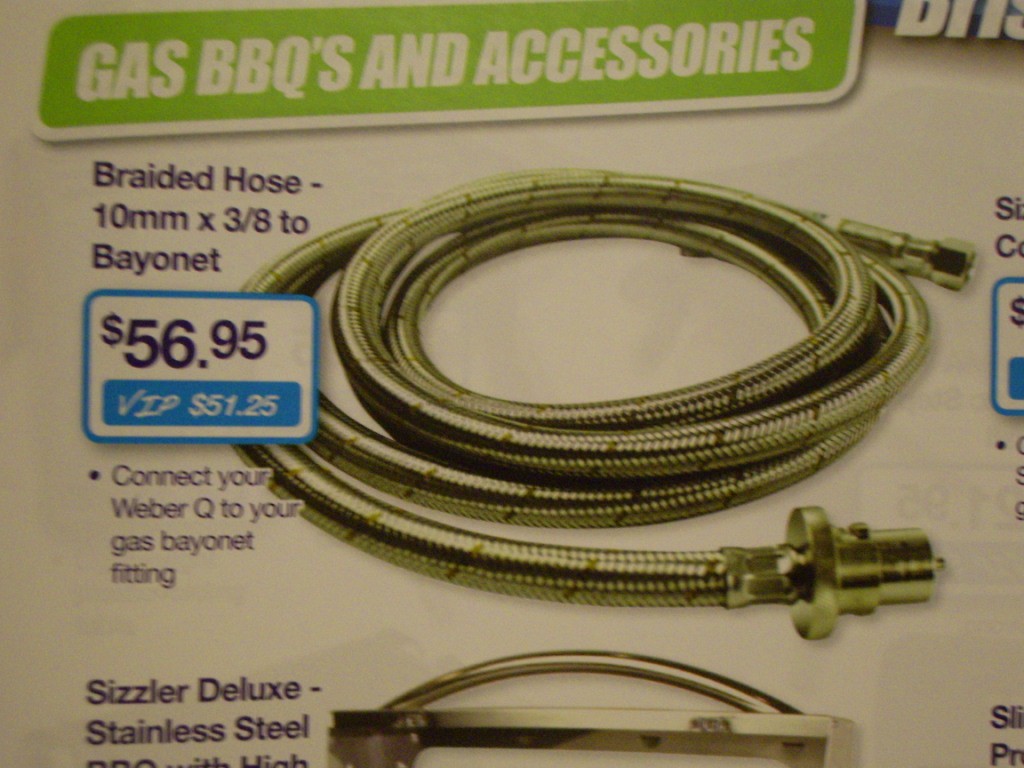

You can buy a 3mt hose from Jayco spare parts. It has a bayonet fitting one end & a fitting the other end to connect to your weber. Was $56.95 in June last year.
Thanks everyone, I've decided to go with the bayonet so will now get the plumber on the job and head for jayco spares for a hose fitting.
Cheers Pete
From the Jayco catledog
Ashley
