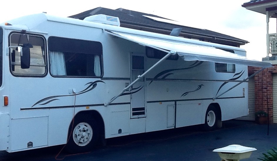

hi everybody.i have just purchased a 11 metre converted hino domino bus .problem is it has a front mounted motor.top speed is 90kph downhill with motor flat out.any ideas on best way to achieve a more sensible and economical cruising speed.would a change of crownwheel and pinion.give better results,if so what ratio .?or would a two speed diff give better results. all ideas would be appreciated.thanks.alan
