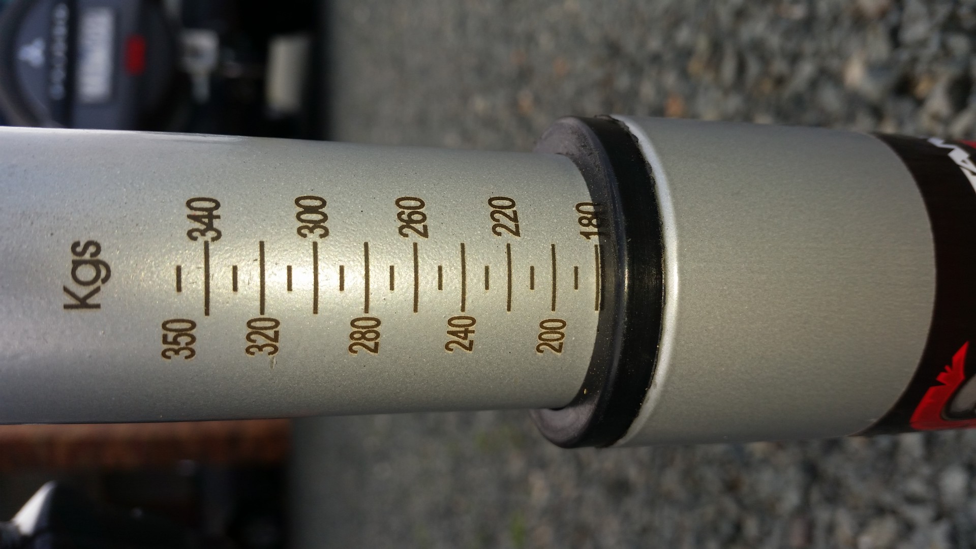

Our caravan tare is 1620kgs, tow ball weight was 140kgs thats every thing out of the caravan, it I could move it I left it at home the reason this excercise was happening was because the van was going in for hail damage repair. I tried to give the repairer a blank page to work with, no spare wheel, no bedding and so on.
Since leaving the factory solar, large battery set up and storage for annex accessories have been added.
Interesting when loaded up 1990kgs with 180kgs on the tow ball. Which made me pretty happy as it has proved a good balance to tow.
On the plate it stated 1644kgs with 144kgs on the ball. Very realistic.
Once you load your van complete with gas, water that balance will change and then adding your personal gear, not knowing your van and if the bedrooms at the front the tow ball will get more weight by adding your personal gear.
All my weights were achieved by using a public weigh bridge approximate cost $25 each time, for peace of mind, just great
From here on in it will a bit of trial and error.
