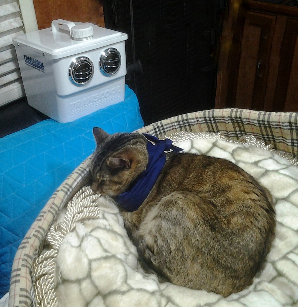

I have just bought a Aust made Transcool Evaporative Cooler. It is lightweight, portable, runs on12v or 240v, and as I'm presently in a climate with 10% humidity it works to cool (not refrigerate) the van. I find the air conditioner still is needed and works in the heat of 35* - 42*C. This dry climate dries my eyes and they had become quite sore BUT using the Transcool AND air conditioner AT THE SAME TIME during the day has worked wonders. The van is cool at 23* AND the Transcool adds humidity to the air which has cured my eye problem.
Mainly I bought it to cool my Purr Baby when I free camp (no 240v) or when I have to leave her in the van when I go shopping in hot weather and are traveling. But have found it great for overnight to get a comfortable sleep with the windows open when it is slightly cooler but the refrigeration air conditioner is overkill. I think I will get a lot of use from it.
