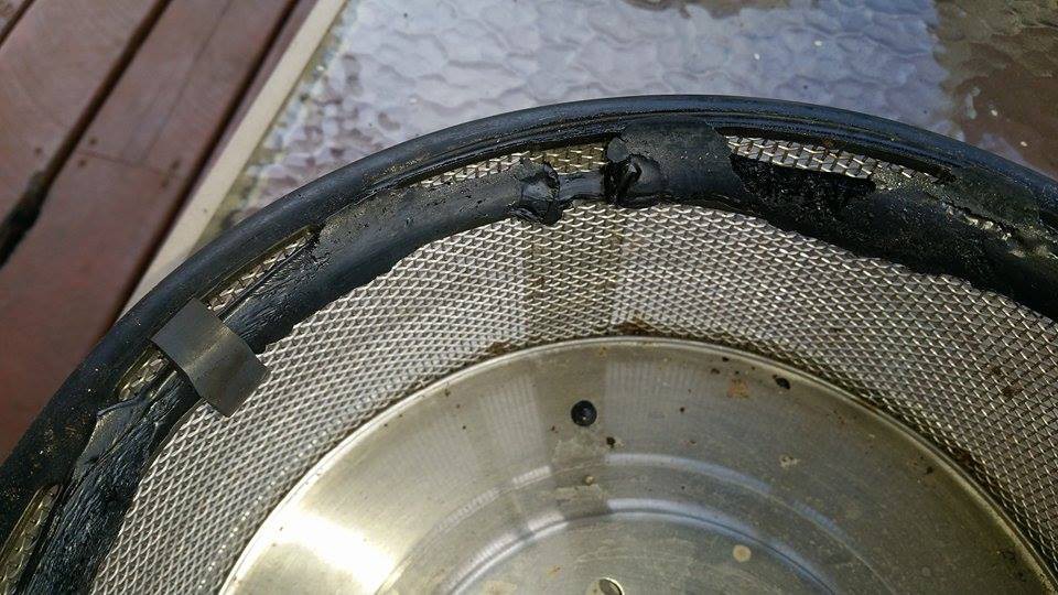

We love our Cobb Cooker, and use it frequently for bread baking and lots of other things.
We had a major mishap, the plastic Top Ring suffered a melt down. Of course , those at Cobb were amazed that such a thing could happen and had no explanation without lab tests and etc. as it is such a rare occurrence. But, a quick google showed its quite common and caused because the "Grommets" (or heat insulators) age and need replacing before they collapse, and hence a melt own.
Parts are readily available from Cobb and delivered postage free ( because its a common occurrence ??). The Top Ring costs about $20 and the replacement grommets are about $10. Could be that timely replacement of the grommets is a good maintenance routine to avoid the dreaded meltdown.
There's a pic of the melt down and also a pic of a loaf of bread it turns out

I noticed that if you leave the top on after you finish cooking it overheats the plastic
