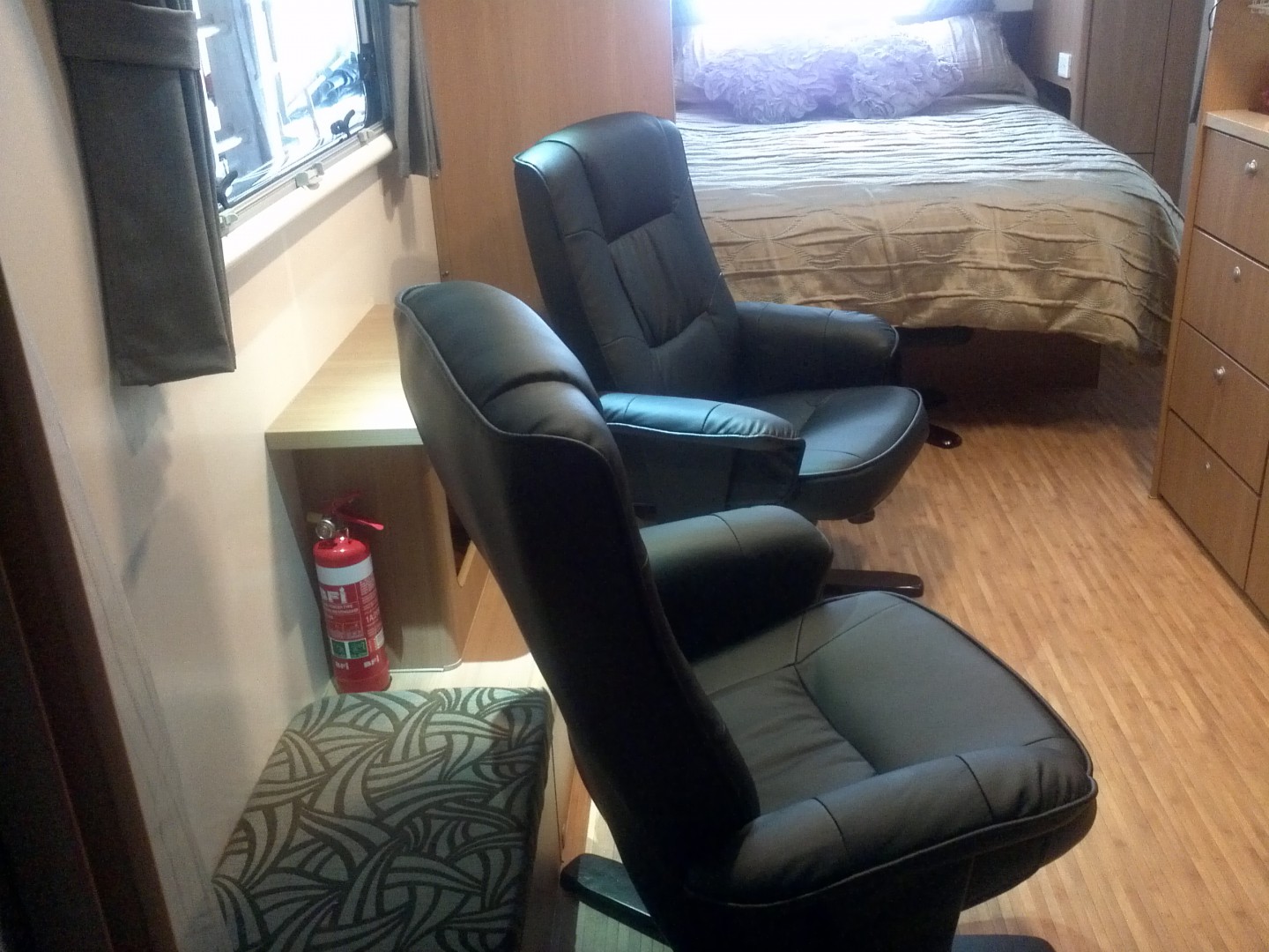

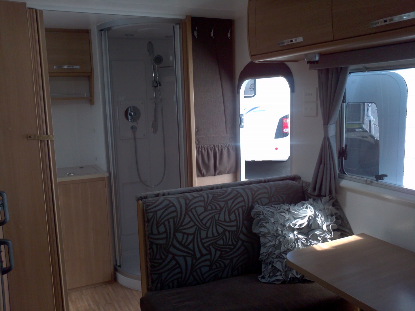

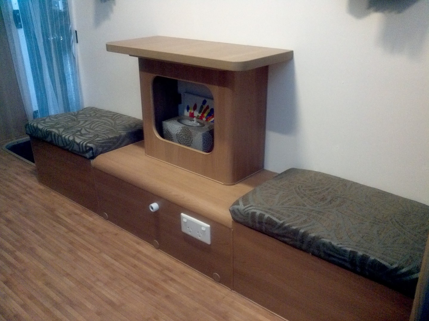

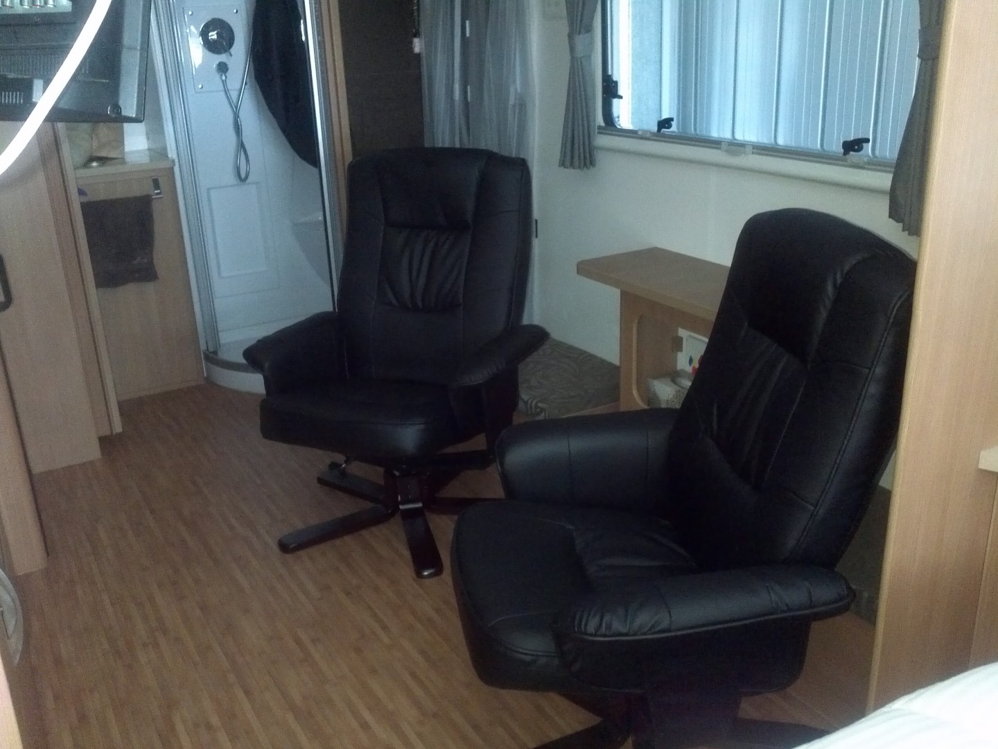

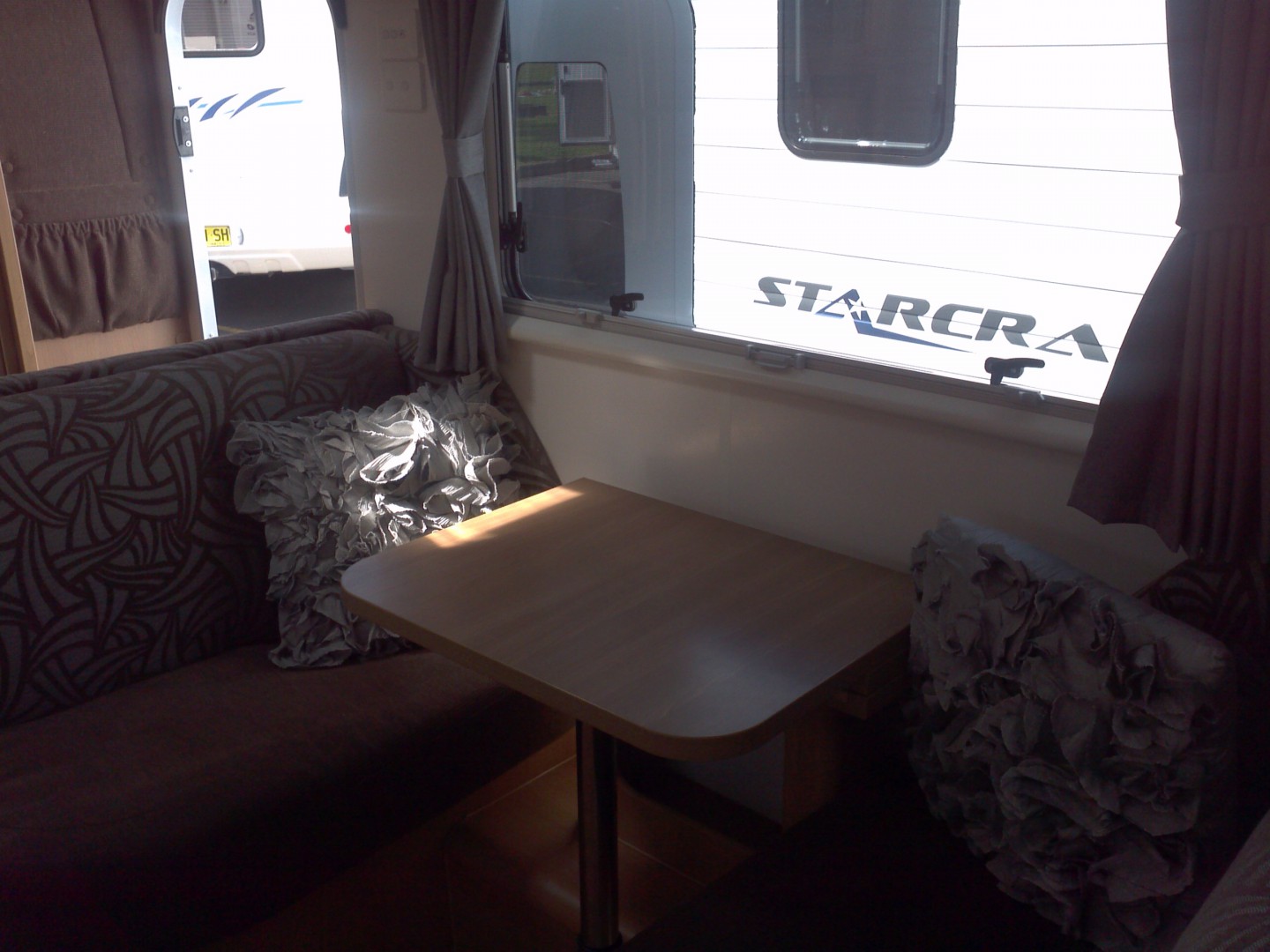

We are on our 5th and final caravan. I love everything about our 2014 Jayco Starcraft EXCEPT the hard, rigid lounges. So after much searching and planning we have replaced them with very comfy swivle recliners with footstools. The material from the original seats made new storage bins over the wheel arch. Wall cushions were trimmed to top them, providing extra seats if needed. Velcro strips and plugs hold the lids on. The tri fold table which we rarely used, was removed and the fixed leaf was reversed to show the nice curved, trimmed edge. The wall into the bedroom was trimmed down, re edged which gives us so much more room. The new chairs are only about 3 cm further out than the end of the fixed lounge and they are moveable. We still have a few small cosmetic things to patch but it looks fabulous. I have a few before and after photos but they dont do it justice.
I just cant beleive how well it has turned out, I am just so happy.

Our van 19.5 ft with double axle. We bought the chairs online for less than $170 each delivered. They come in boxes so they are assembled inside the van. This also included 2 matching ottomans. Hubby did it all himself, with intermittant supervision by me lol. The only extra materials we bought were glue, a staple gun and a disc for the angle grinder to cut a channel down the edge of the bedroom wall to insert the rubber edging frlm the other seat we removed.

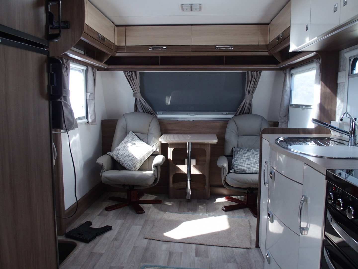

The chairs are not bolted down, free to move, there are a couple of straps on the end wall to secure them during travel. This is a standard Jayco layout on the 24ft Silverline. Just to add, you should have at least 1800mm of space for the chairs to fully recline. I.e. a 6ft person lying prone.
In fact if you look at the picture closely you can see both chairs are secured by a black strap.
