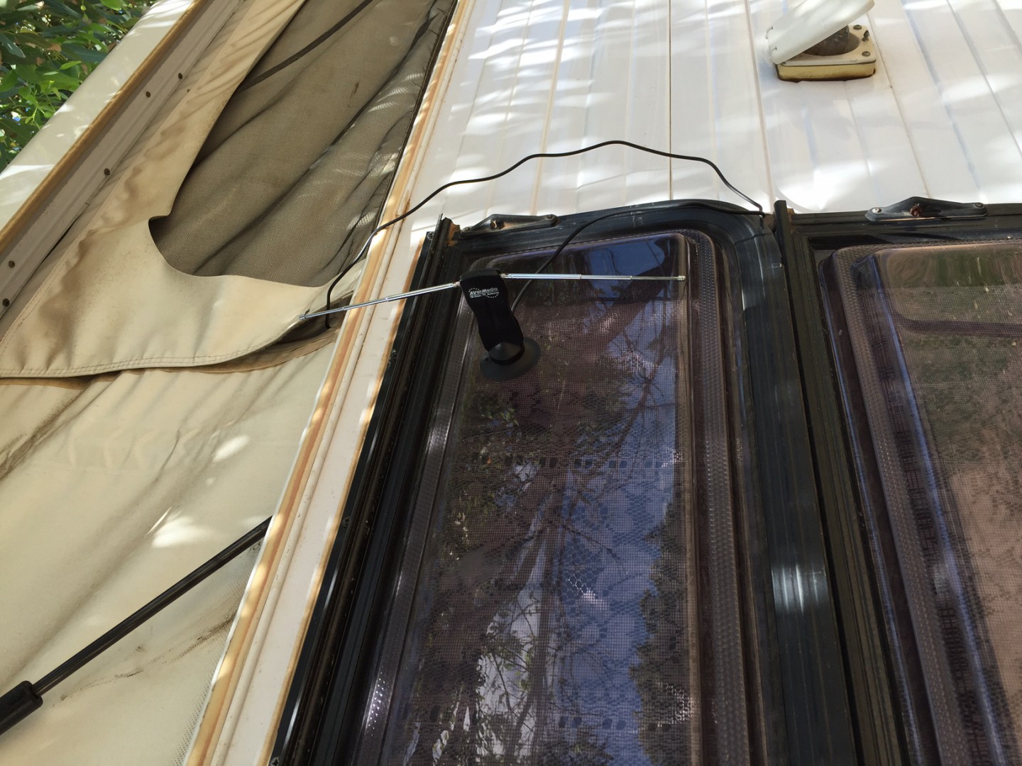

There must be a few of you familiar with said caravan park in SA, I know we have been coming down here from Adelaide for quite a few years and the tv reception has always been very hit and miss (more often miss)
After stuffing around for A LONG TIME with 2 antennas and various boosters etc etc., I gave up!
Next day I was looking for something else in my bits and pieces draw, and found this little antenna that came with a computer tv tuner card some years back. The whole thing is about 8" fully extended, so I thought I would stick it on the outside window with the suction cap that came with it.
I then retuned the Telly, and it then picked up 31 DTV and 5 radio stations!! And with NO booster!
Looks to me like you are now setup to receive a vertically polarized signal that you would not get very well with a horizontal polarity antenna.
TV transmissions from Newland Hill are vertically polarised and that would be why that little antenna is working. It is most likely your caravan antenna is a horizontal one.

woofta and precious said
04:08 PM Dec 9, 2015
Hi KFT,
I had tried that with a "Wanderer" antenna, and also a Dick Smiths one that you can mount vertical or horizontal, but the best I could get in any position was 5 channels. I tried them up high on every corner, down lower on the drawbar, but to no avail...
Regards,
Brian

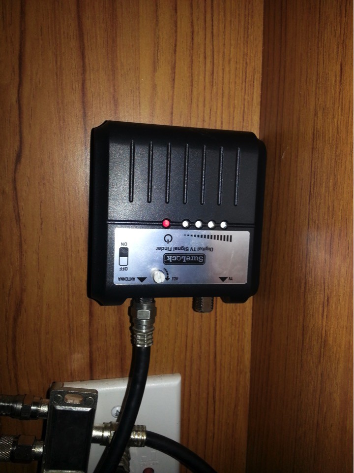

Tomcat said
02:02 PM Dec 11, 2015

This to me makes a lot of sense I would be curious to know why some places are vertical and others Horizontal. I believe the big cities are Horizontal. Just on the subject a bit of a time saver is this signal detector I move the ariel around till I get the strongest signal then tune in the channels.
quote"I move the ariel around till I get the strongest signal then tune in the channels."
Which is exactly what a professional installer does with a signal strength meter to find the best location for a TV antenna or they should be doing if they know their job.
Frank

Hi all,
Still scratching head...
G'day W&P
frank
-- Edited by KFT on Wednesday 9th of December 2015 04:07:29 PM
Frank
