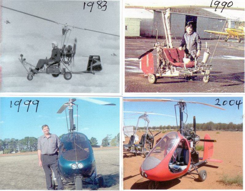

FWIW.. 15 years ago I was operating Subaru 2.2 ltr engines in my gyrocopters. These engines run 5400 max on take off and cruise around 5100. I was training people to fly and was doing around 150 engine hours per year. I was changing the mineral oil and filter at 25 hours as per manual. I would find that the oil pressure had deteriorated 5 psi by 25 hours. I decided to try the dearer fully synthetic oil and would find no deterioration of oil pressure by 50 hours when I changed oil and filter.
Pics below show VW powered in 1983, Rotax 2 stroke 1990, and Subaru for the cabin machines. In 2004 I flew the red cabin machine from Ballarat to Alice Springs and back for our Gyroplane Nationa Championships
-- Edited by aussie_paul on Monday 7th of December 2015 12:40:42 PM
